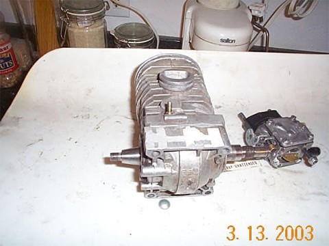

here is the 029 on a scale at 3.5 lbs no prop adapter ,carb mount and beam brackets and a shaved head and still weighs 3.5 lbs.
Darin

here is another pic.
