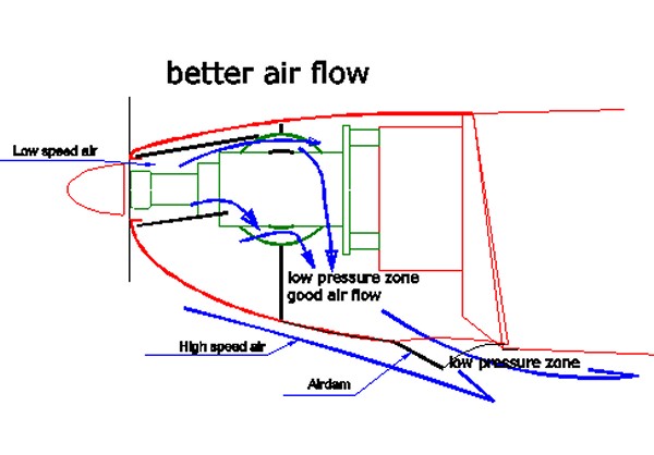

Hi
I have a Evolution 58GX2 and its been sitting around waiting for a plane to be flown It has broken a few. I was wondering if any one knew what the flashing ment when you first turned on this engine. When i power it up I get one long flash and 3 short flashes. Last i recall the thing only had 3 short flashes on power up. I dont have a choke servo conecter to this thing so following along the instructions to reprogram it is a bit of a task I know i could mange to reprogram it but the code its flashing has to have some meaning.
Ive run this engine in 2 differant planes and its failed me both times. allways has good power and good transition on the bench but after 8-10 min in the air it will act like the low end setting has leaned out and fail to spool up after a touch and go. Failing me in a low hover has happened 2 times rtesulting in a loss. and both times it was after i had been compleetly satisfied with the settings and have had many good flights. Sending this back to Horizon wont help I can tune this thing and make it run good for a few flights but it wont last. I dobt Horizon will test fly this thing for 4 or 5 flights. If i run the low end needle setting ritch it wont do this if i pick up the throttle slow it wont do this but i think thats asking a lot more out of the pilot and a lot less out of an engine that is supposed to be top shelf. Ive also run the plane without the coweling so it isnt heating up thats doing this Horizon has offered to look at it but truth is i doubt they have the time to realy test it as its had some days when it runs flawless all day and on the last flight it it eather destroys a prop or worst I have lost many props and 2 air craft. Loosing shipping cost and finding out that they are unable to reproduce the failure dosent exactly make me feel overly confident that shipping it out will solve this. Ive repaired the last plane it managed to leave in the bushes. and its destryed another prop due to loss of power on a touch and go and yes it was the first flight after the last repair about the 4th touch and go. It has new tank lines and clunk line. I would like to get to the bottom of this myself It would go a long way in allowing me to trust this motor with a new plane. Im going to run this ritch for a few more tanks before I attempt to reset the needles. Ive been a mechanic all my life and I have some experianc e with small engines Most flyers trust me to tune there engines. But as allways I keep my ears and mind open to Ideas and this one has me 2nd guessing myself.
Thank you all for reading this Hope some of you have had this experiance and have found its cause. Or have some possative Ideas.

It seems to me that your engine is running way to hot.
Normal two strokes will give warning by sagging in rpm. This is not the case with MVVS, because of the piston plating with graphite.
The increased problem with 3D flight shows in that direction.
Advise for the time being is to run the engine extremely rich.
But in the long run, I think you need good cooling by air guiding and air extraction to run these powerful engines up to their capability.

Old 08-19-2007 | 03:29 AM
Posts: 6,571
Received 5 Likes on 5 Posts
From: Arcen, , NETHERLANDS
Default RE: Evolution 58GX2 ign. LED flashing
look at the sketches, and choose your cooling system. Then you will see that a lot of air can circulate inside your cowl, but it is not set to work on the required cooling business because the air is not forced to go through the engine cooling fins.
Powerful engines need a powerful cooling system. Lack of proper cooling makes itself noticed especially in upline verticals and hoovering.

Old 08-19-2007 | 02:21 PM
bluemagic98's Avatar
Joined: Jul 2004
Posts: 869
From: Wisconsin Rapids, WI
Now this is good information thank you very much

Well it seemed to get hot and loose transition today it was a tad warmer out so i added this cooling setup ( see pic ). Ill be out with it tomorrow and run her hard see what gives.

The cooling was a marked improvment thank you. Flew the plane all day and she never quit. I was wondering if you knew how much end play you should have in the crank shaft? seems a tad excesive to me. Im going to put a dial indicator on it tomorrow.
