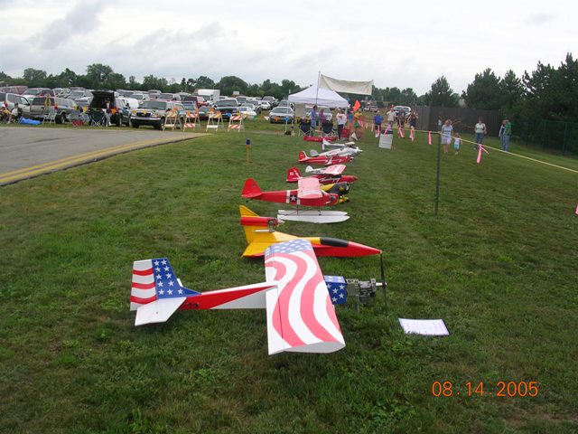

BTW the picture shows a Ryobi 31cc. I put the G-38 on this year.
