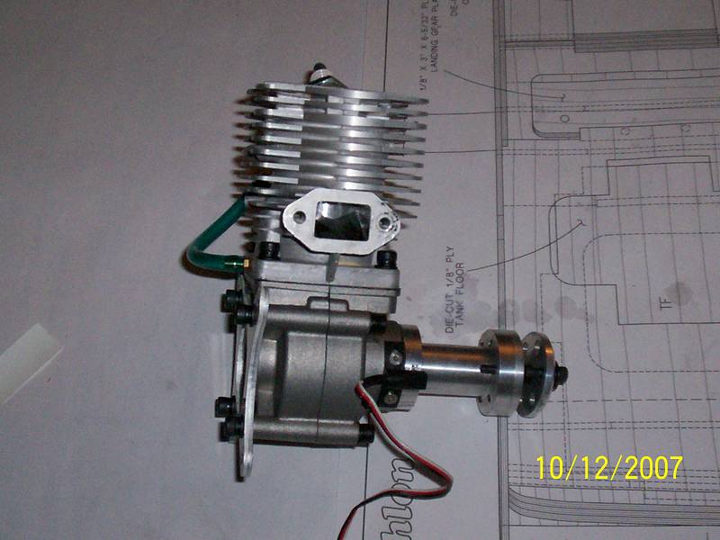

The other day I purchased a Master Torque 42cc engine from rcextremepower.com. The price was a big selling point at $289. After ordering the engine, got it in 3 days, not bad. They test ran the engine for 15 minutes before shipping, ahhhh the sweet smell of gas when I opened the box. I haven't had a chance to bolt it up and run it and the more I got to looking, it had a familiar look. So I went to the Cermark to look at the SPE 40cc, and sure enough they look almost identical. Carb, muffler, back of the crankcase is different, and it came with an RCxel ignition. I have a zenoah g38 on a Goldberg Extra 330, fly's great, the weight difference between the zenoah and the Master Torque is unbelievable. When I got the box, I thought there was no way this could be the engine I ordered. Here are a few pics, there isn't a comparison photo of the SPE, but if you've seen one you'll see the similarities.

Odd cylinder, I like the mounting plate on the back, should help you to keep from breaking the mounting lugs. I had a 50cc I broke lugs off 3 crankcases[:@], I only had to pay for one, but it still almost crashed my plane once. I just bought some 1/4 inch American aluminum plate to make mounting plates for my rice burner engines from now on.

That is one of the differences between this and the SPE. On the SPE the brackets are one piece with the crank case, this one has a backplate with aluminum mount.

I believe SPE also sells that backplate as a repair for broken lugs. The cylinder appears to be a re-worked SPE. Hard to tell just from the pictures though. Looks like one of TomyRCmodels efforts.

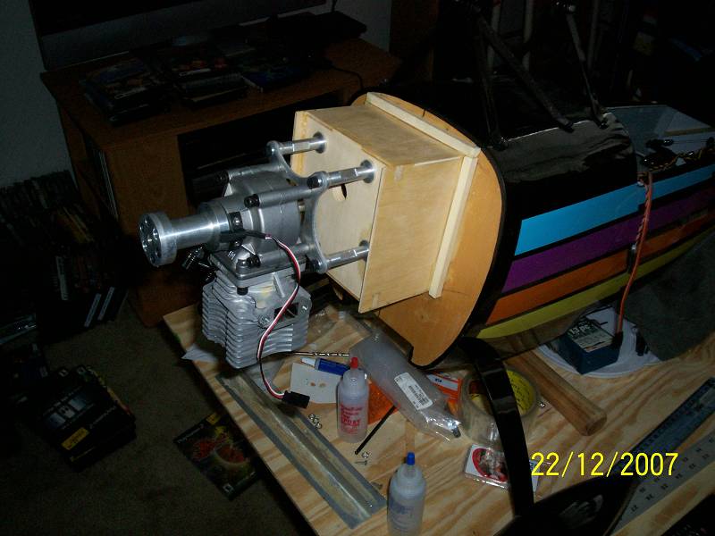

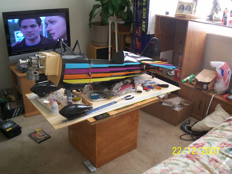

I was thinking a 20x10 would work but maybe too much pitch. I was trying to determine prop size based on what 40cc to 45cc engines run and get a happy medium, but a 20x6 for break in and a 20x10 sounds good. I did get the firewall drilled out, cowl cut out to fit on the Christen Eagle. Hope there is nice weather next week, should have it all together to fly. Will post some pics of it tomorrow

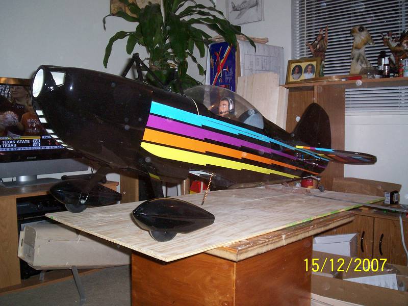

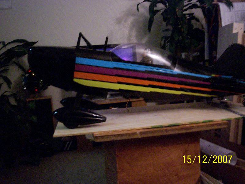

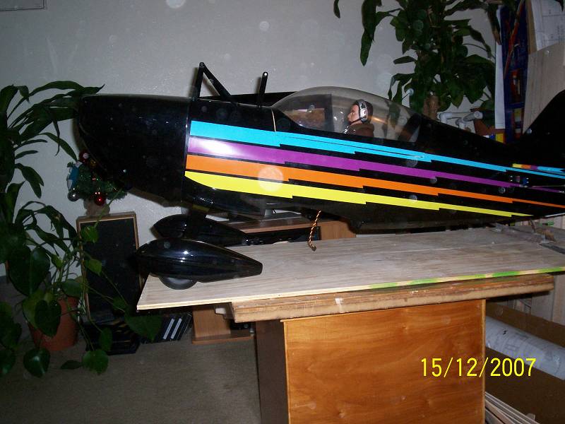

A few pics of the Christen Eagle with the MT 42cc.

Black airplanes are a ***** to fly.
