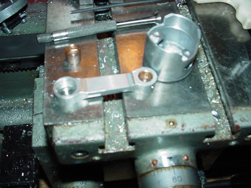

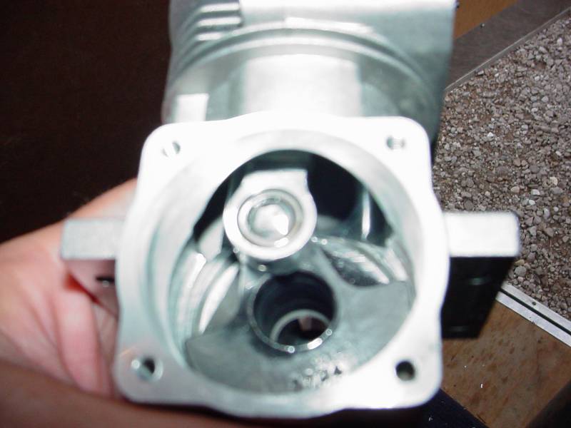

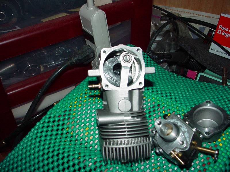

Default RE: BME .90 (15 cc) Super Tigre conversion
here are some pics of my conversion
ID:	872058   Click image for larger version
ID:	872059   Click image for larger version
Old 02-07-2008 | 01:30 AM
PlaneKrazee's Avatar
My Feedback: (14)
Joined: May 2002
Posts: 4,878
From: Gales Ferry, CT
Ken,
Are you using a Holo-Krome crank pin like Keith?
Old 02-07-2008 | 01:42 AM
KenLambert's Avatar
My Feedback: (107)
Posts: 886
From: Augusta i i IL
a hardened and ground pin
Old 02-07-2008 | 02:44 PM
Posts: 12,957
From: Hesperia Michigan, MI
Ken: Is it a good idea to add a extra hole in small end of rod for lube? I know guys that do, on 4 cycle engines. Nice looking work in the photos you posted. Best Regards, Capt,n
Old 02-07-2008 | 03:57 PM
KenLambert's Avatar
My Feedback: (107)
Posts: 886
I ad 2 on top / side/ staggerd
