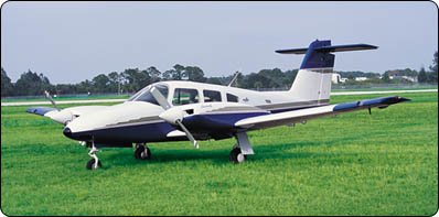

I'm having some plans drawn up for the Piper Seminole. It's going to be 1/4 Scale. 115.8" wingspan. Thing is I don't really know what size engines I should start with. All up weight is estimated around 25 to 30lbs max. Probably more like 20 to 25lbs though.
Any ideas???
Regards,
Bryan

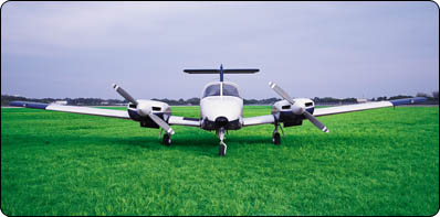

Default Another Picture.

TWO FOX 2.4'S OUGHT TO HAUL IT AROUND. NICE LOOKING BIRD. THESE ENGINES SWING A 20X8 MEZJLIK AT 7300 RPM WITH A BOLD MUFFLER INSTALLED. MIGHT BE EXACTLY WHAT YOUR LOOKING FOR.
