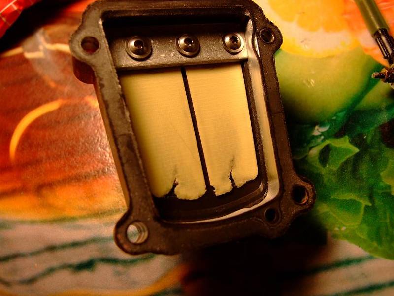

I have a similar problem with my 55i US ..
After 1 year , after many fights over email with the guys from 3W ... after many modification of the cowl to overcome the airflow problem I decide to open the carburetor and see what the hell is going on. The caburetor is ok but the reed valves was .. see for yourself.
I've ordered from A.I. the new valves and i'm waiting for the flying season to begin .
