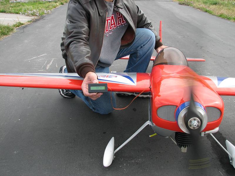

all of the optical tachs can easily misread -badly-- if reflection is incorrect .
the H9 seems to like about a foot distance and then you must get light correct-
On my ZDZ engines - the ignition has a output which is directly read and is accurate - why the rest of the ignition guys ignore this -is likely a cost issue.
