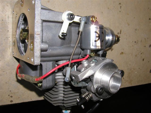

The G26 carb has a very awkward positioning of the throttle lever and it makes installing a throttle cable challenging. You need to get the carb mount changed or modified by Ralph or it could be frustrating for a first timer.Don't know why the design is so bad.

You could also simply install a 90 degree bellcrank in the open threaded hole on the side of the engine case above the carb. That takes all the challenge out of the throttle linkage....

I flew my Rascal with a G20 and had plenty of power, that plane doesn't require much. About throttle linkage, if you don't want to get a rotator intake manifold for your G23/26 this is an easy set up using a bellcrank.
