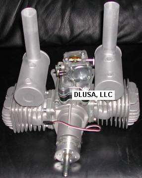

I was on the phone awhile ago with Bob at DLUSA. He doesn't have a firm "in house" date yet, but said he'd let us know. I expect it will be well worth waiting *and* paying for.....
Will have to figure out what to do about that dang one backwards muffler, though. That is "weird", if there ever was.....but maybe on true production units it's changed, who knows?

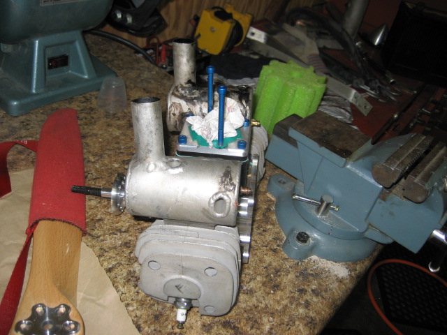

THere's a pic floating around somewhere, can't remember where..... it shows the downward pointing tube, offset to one end of the muffler body, but is installed such that there is a tube exiting more toward the front of the engine than the other.
Found it!!!!! Pic is on this post in the DL 50 thread - http://www.rcuniverse.com/forum/fb.asp?m=7447187 (The top pic is the DL the other one is something else)
Now *LOGIC* would tell one to simply "turn around the muffler".... but since I haven't had one in my hands.... well, see my earlier post about me being on the bottom of the learning curve now....

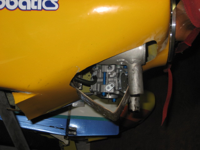

Of course, "DA" 100 mufflers would fit up, as would the J'Tec, and the "Silent Power" (Troy Built), and they all have the "front bottoms" angled so there is less cowl-cutting....but it was interesting to see the pic, huh?

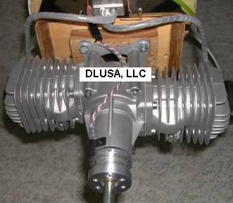

RE: DL 100 - New Twin on the Block!!
Another GREAT report! Thank you!
What oil ratio are you currently using?
Do you have the static port on the carb tube-connected behind the firewall? It looks to point dead ahead; wondering if that needs minding?
Standoffs?
Stock mufflers?
Standoffs?
Stock mufflers?

I have it running on "broke in" gas now; that's regular mixed with Amsoil Saber Professional mixed at 85:1.
I purposely left the static ports exposed to see if there would be any problem and I haven't noticed any. I plan to install isolators (soon I hope), to see if they have any effect.
No stand offs were used in my application. The mount to prop hub distance is 6.6in. so spacing may be required on some installations though.
Stock mufflers are installed. On the quiet scale they register "not".
Regards,
Bob
www.dlusa.net
