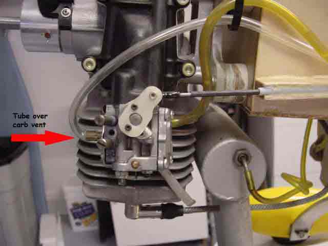

If the diaphragm vent hole is into the air stream. Solder a piece of brass tube over the hole. You may have to put a new hole in the plate (center) and seal the other one off.
Attach a piece of fuel tubing to the brass tube, and put the end through the firewall and into the fuse, so it will have undisturbed air.
This picture was not taken for this purpose, but you can see the tube in it.

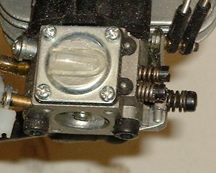

I put a small plastic shield over this vent get it out of the prop blast. Some people run tubing from this vent hole into the fuselage like the previous picture shows. The vent hole is under the plastic shield in this picture.
Pointing the velocity into the prop blast is only going to cause you more problems. If anything face it away.
