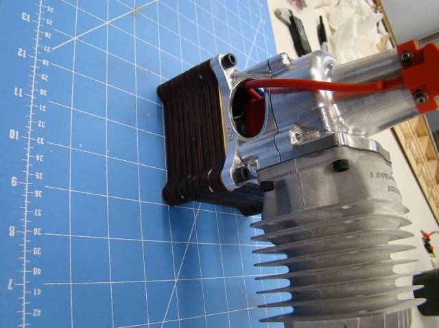

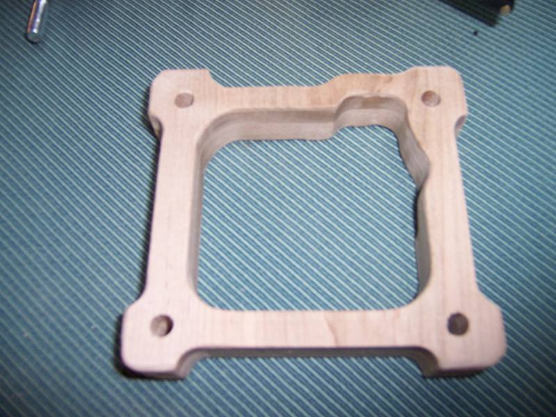

Old 07-04-2008 | 05:22 PM
tkilwein's Avatar
Posts: 546
From: denver, CO
Default RE: DA-85 Stand off question

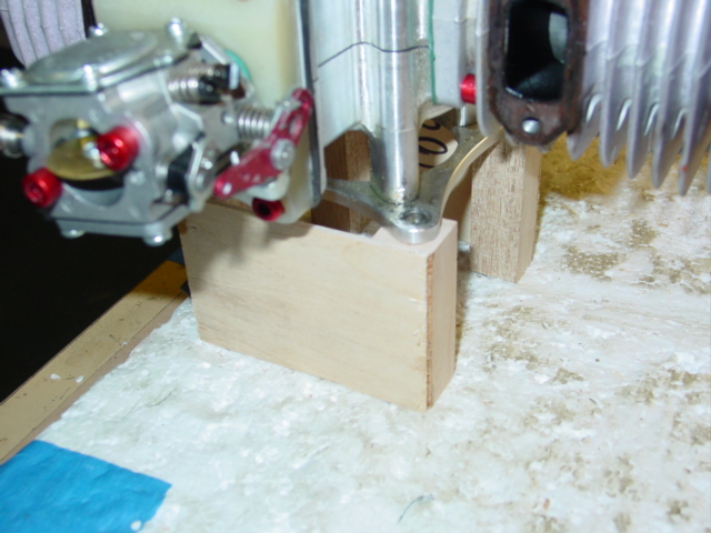

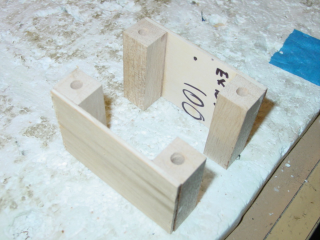

Here is what I did for standoffs, I made the walls thinner after pictures taken.
The mount is even and parallel on both sides, notch on back side for needle adjustment.
Cross laminated maple stock for strength and milled it out.

Old 07-04-2008 | 07:57 PM
Bass1's Avatar
Joined: Dec 2002
Posts: 2,472
From: Va.Beach, VA
Looks nice!

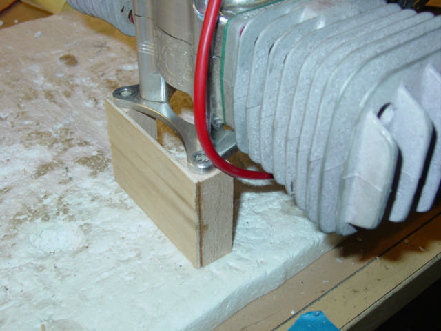

rctom's Avatar
Joined: May 2002
Posts: 6,189
From: Flower Mound (near Dallas), TX
ORIGINAL: Mr. Mugen
The biggest dowel I can find around here is a 1 1/4" Poplar. Is Poplar going to be ok? I am trying to fit this DA-85 to my Edge 540 H9 33%.
Kevin
This is how I mount all my engines now. I have these available in custom lengths for DA-85 and DA-100. A kit costs $25 and includes the long 10-32 socket head screws, fender washers and 10-32 blind nuts. I've used it on 4 DA-85 installations now, rock solid, very light, and it leaves room on the sides to access the linkage and needles.
One neat feature on some planes with DA-100, there's enough room between the engine and the firewall to put the ignition in the gap. This works out very nicely, keeps the ignition out of harm's way.
Tom Fawcett
Wild Hare R/C

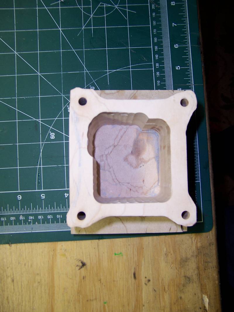

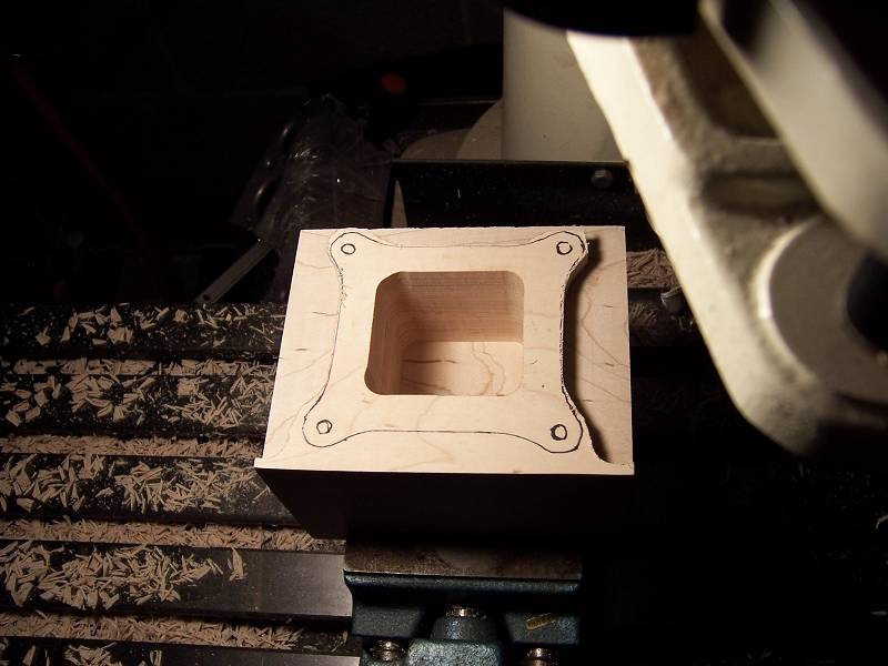

Old 02-19-2009 | 08:29 PM
Mr. Mugen's Avatar
Joined: Mar 2006
Posts: 8,048
From: U.P., MI
Well off to the mill next. This is going to be interesting.
Kevin

Old 02-19-2009 | 09:30 PM
Mr. Mugen's Avatar
Joined: Mar 2006
Posts: 8,048
From: U.P., MI
Well when time is on your side why not eh. Seem to have lots of it lately. Not sure this will work out but at least I will have tried and learned something if nothing else. I have never milled wood before and just thought what the heck...I'll look up properties of wood in my machinists handbook and found it! That book has it all. Learning a ton from it and it has not even been cut yet. Didn't know they broke wood down so far. This is interesting stuff for sure. I hope a 2 flute mill will work good. If nothing else it may serve as a good rougher. I need to order more tooling bad. Limited to about 10 endmills and a few face mills. Just getting set up with my mill and lathe. Never would have pictured wood chips on my mill though.
Kevin
Old 02-20-2009 | 12:40 AM
Posts: 18,602
From: Valley Springs, CA
Your end mills will last a lot longer on wood than metal. Hardwoods are really good stuff and a hell of a lot stronger under compression and in shear than many realize. You'll enjoy working with it.
Old 02-20-2009 | 05:26 PM
Mr. Mugen's Avatar
Joined: Mar 2006
Posts: 8,048
From: U.P., MI
Your not kidding! I am turning my 1/2 inch 2 flute endmill at 1750rpm and feeding it at about 5-7 IPM...guessing it is all manual. It cuts great with no signs of trouble yet. Just getting the center of it hogged out now. Wondering it I should do the outside profile first? Not sure but heading back out for another 15 minutes before we gotta leave for the sled dog races.
More later and a pic too.
Kevin

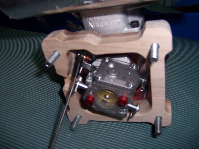

Old 02-20-2009 | 11:24 PM
Mr. Mugen's Avatar
Joined: Mar 2006
Posts: 8,048
From: U.P., MI
Well I think I will stop right here and drill out the bolt holes. Not sure if cutting them last is a good idea or not. If something wants to blow it will be much easier with all that material gone....what do you think? Kids are in bed now so I am done working on it for tonight. Shop is right below the bedroom wing.
Kevin

Old 02-22-2009 | 12:47 AM
Mr. Mugen's Avatar
Joined: Mar 2006
Posts: 8,048
From: U.P., MI
Well it is still in the rough but it is all set to be finished now. Got the holes drilled and they all line up perfect. The bolts drop right in with no play. Now to cut it off the block and mill to right height. Should be done soon. Thanks for the idea tkilwein....appreciate it.
Kevin

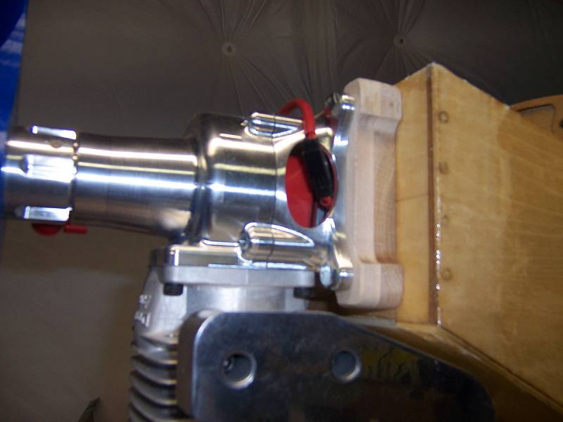

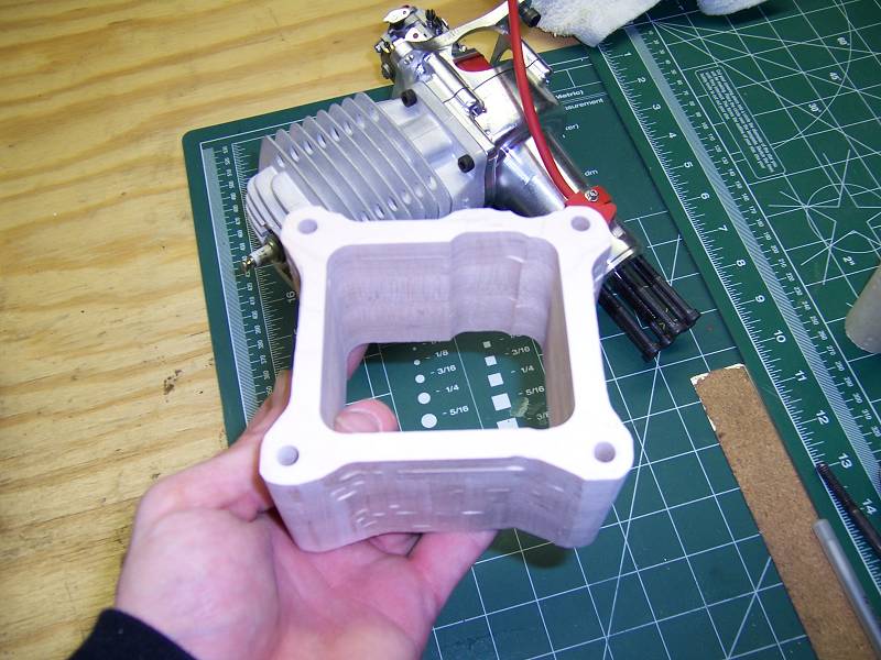

Old 02-23-2009 | 06:21 PM
Mr. Mugen's Avatar
Joined: Mar 2006
Posts: 8,048
From: U.P., MI
Thanks you all for the insight and pics. Esp. Tony for the start on this. He was kind enough to try and make me one with a blow out. I wish I could replace the time you spent on it...sorry. However this one turned out flawless but took some time as I knew it would. I made small passes and a lot of them. I didn;t want this pic to look like Tony's...no offense Tony...just tried taking every precaution from what I learned from you. Your on heck of a guy. Well what do you's think? Still need to hack a hole in side for the adjustment screws and finish sand it a bit...maybe throw some sealer on it too.
Thanks again,
Kevin

Old 02-23-2009 | 10:32 PM
tkilwein's Avatar
Posts: 546
From: denver, CO
Looking good, no offense taken and I would have taken it as a compliment if you copied mine.
Glad it worked out.

Old 02-24-2009 | 08:34 AM
Mr. Mugen's Avatar
Joined: Mar 2006
Posts: 8,048
From: U.P., MI
Well consider it a compliment by all means......I tried to copy yours . I did just that, and made the holes angled as the needles are. Might make way for the choke too. Really would like to not use a servo for choke since it only gets used once or twice a day. Will get a rod made up for this part. So close I can taste it! Too bad winter will be around til June. It's a short flying season here and I want this one to be ready for spring.....or summer. We only get 2 seasons here....shoveling and swatting....snow and mosquito's.
Kevin

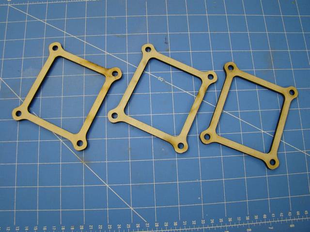

Good news for the DA 85 owners, now it’s easy to build the motor box for this engine. Desert Aircraft states clearly in their manual you can’t use standoffs otherwise the warrantee is voided if a crack in the case occurs.
Well, here is the solution –
Fritz’s DA 85 Motorbox
[link=http://www.wyliewarbirds.com/products/gasmotors/gas.htm]http://www.wyliewarbirds.com/products/gasmotors/gas.htm[/link]http://www.wyliewarbirds.com/products/gasmotors/gas.htm
The price is low and the design is approved by DA. The box is very strong and easy to assemble.
Hope this makes some of you guys happy.
Happy landings
G-Pete

Old 02-25-2009 | 02:45 PM
Mr. Mugen's Avatar
Joined: Mar 2006
Posts: 8,048
From: U.P., MI
Hey better late than never eh. I am sure others will like this option. They are the same thing as the one's PAU makes. Only PAU's have the jog out for the carb which is very much needed IMO. Looking at the pics you provided it seems like the inner lines do not come over enough to clear the throttle arm. I was using the hole center and the inner line as a ref while looking at it. Am I off base here? Or is there enough clearance for it?
Kevin
