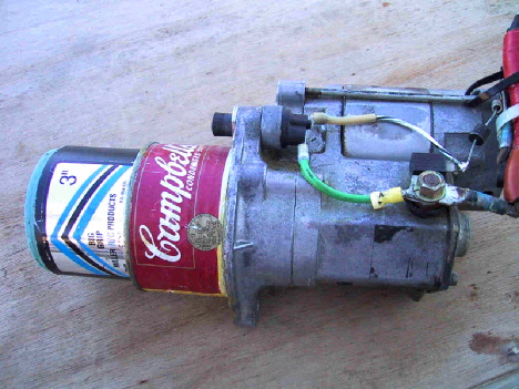

I converted a starter off a Honda Civic. Haven't found an RC airplane engine yet I can't turn over with authority. Ron

I made a KING KONG starter from an aftermarket geared down starter intended for a Pontiac..Made a 4" aluminum cone for a 3" Miller rubber sleeve..Put a flat plate across the front with 2 handles...A momentary on kill switch from a chainsaw..12 volt battery on a small 2 wheel cart..Welding cables from the battery to the built in solenoid on the starter...Turns my 289cc Herbrandson race twin 3000 rpm....Insdtant starts all weekend at the races.... Overkill ? Ask the other racers whose wimpy starters won't start their race engines...

Old 06-04-2003 | 11:19 PM
Big_Bird's Avatar
Posts: 4,258
Received 7 Likes on 7 Posts
From: Arlington, TX
Default Giant starters
Here is a converted geared Nippondenso starter from a Mitsubisi V6. I haven't found a big R/C gasser that it won't spin with authourity. It also uses automotive jumper cables for leads.
Ken
