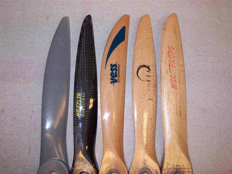

18 inch props - APC, Mejzlik, Vess, Xoar, MSC
Notice how different the tips are from each other. Notice the difference in width. The 18x8 MSC is also a much thicker prop than any of the others. Since it's a top view, you can't tell.

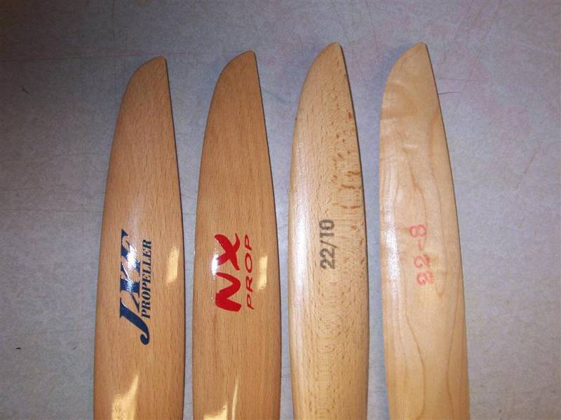

22 and 23 inch props - JXF 23, NX 23, MenzS 22, MSC 22
In this size, the flat at the tip of the identical JXF and NX is less pronounced, looking very similar to the MenzS. The MSC is very thick, and simply wider from root to tip than the others.

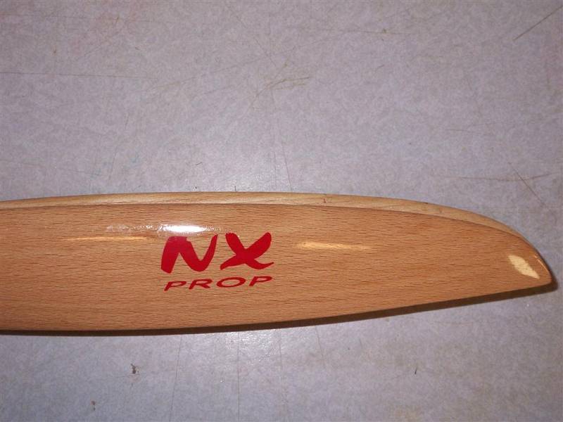

23 NX offset on top of the 22 MenzS
- notice the trailing edges are identical in profile
- notice the leading edges are not exactly the same, but quite close
22 MenzS laying directly on top of the 23 NX
- awfully similar.
The biggest differences between the NX and MenzS might slight differences in the airfoil profile as well as the wood quality and stiffness.

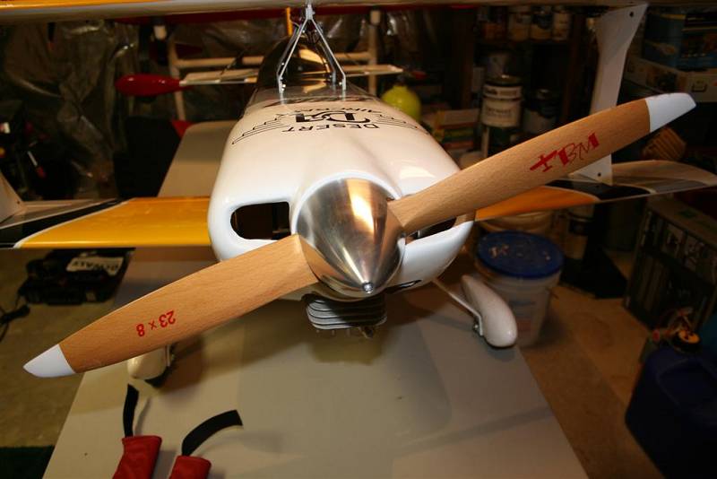

I am running a TBM 23x8 classic beechwood prop on one of my DA50s. I break my 50s in on 22x10 TBM props. They are very economical before you switch to a more expensive wood or Carbon fiber prop. The TBM props are a little soft and a little louder than some of the other wooden props but they come fairly well balanced and have done a great job for me!!
