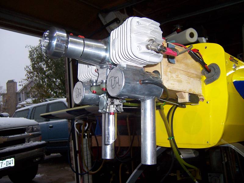

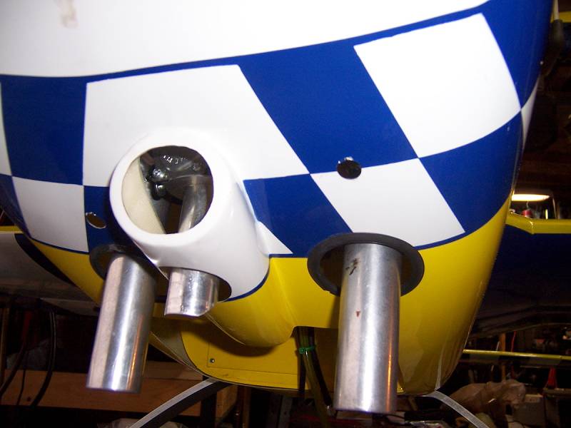

Old 08-28-2008 | 09:08 PM
tkilwein's Avatar
Posts: 546
From: denver, CO
Default RE: Velocity Stack Help ???
I mounted mine backwards and it runs good.
Going to flip/re-tune and see if it runs better after reading this thread.
ID:	1021401   Click image for larger version
