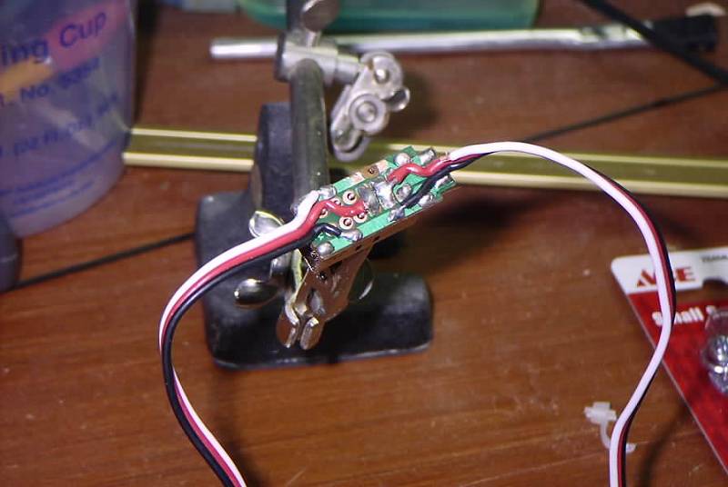

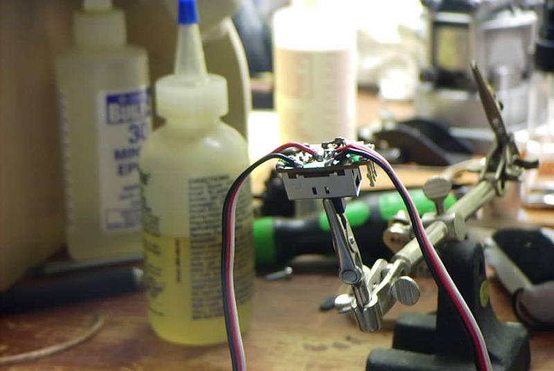

While replumbing the tanks in my Super Stinker, I wanted to relocate my main power switch to the opposite fuselage side.
This switch is one of the more popular, "heavy duty" models with a charge recepticle incorporated into the unit.
A flying friend saw mine last weekend at the field and commented that he had lost an airplane because of a faulty switch just like mine. Evidently, one if the wires had a bad solder and popped off the tiny board, causing loss of current and the inevitable crackup.
Since I had the switch in my hand, I decided to take a quick look to insure my switch was ok. Afterall, I had already flown the device with no issues.
I popped the black plastic back off and carefully removed the switch from the housing. I immediately noticed that the foil that is adhered to the epoxy board was peeled up on the one edge and that the black wire had a rather oversized blob of solder.

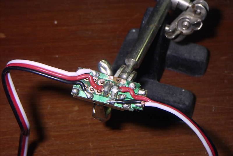

Using a jewelers loupe, I examined the wire and the board and discovered a flaw. Evidently, the wire had been soldered, removed and re-soldered at the factory. Problem being, when the 1st solder was removed, it peeled a small portion of the foil off with it. In order to bridge this "gap" an inordinate amount of resolder was needed to make the contact. However, solder does NOT adhere to epoxy board and since only a very slight edge of foil actually was making the contact, as soon as I slightly touched it with a pik-probe, it popped right off the board, large solder blob and all. The board was bare, exposing that 2mm gap in the foil.
I decided to remove all the wiring, clean the board, reflux and resolder the wiring harnesses to insure reliable service.
I unsoldered all 6 contact points using a braided wick, cleaned it up with tuner cleaner(contact cleaner for you kids that never saw a manual tuner in your life) and fluxed the contacts for the redo.
I used a jumper to bridge the 2mm gap in the foil, resoldered all the leads and reinstalled the switch into my fuselage.
Man, it sends chills down my spine to think of what the vibration from the 41cc gasser could have done to that crappy solder job from the manufacturer!
It pays to pay attention to the little things that can ruin your whole day, (and investment).

Good tip, and explanation of the fix. Any chance of getting you to share the make of the switch as a heads up to others that may face the same problem? .....and perhaps some pictures of your work?

I really did consider posting the make of the switch but hesitate to do so.
Since I've already solved my issue, posting photos would show the "cure" but not the disease, as it were.
However, I guess you're right...any visual is usually better than a written explanation!
I'll fire up my cheap digital camera tonight and pull the switch back out of the Pitts to post a few tonight.
The model of switch will be self-evident once I post the photos...

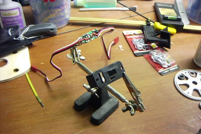

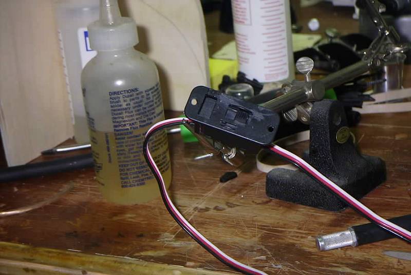

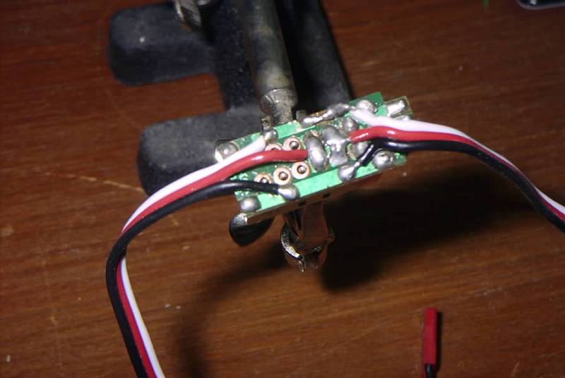

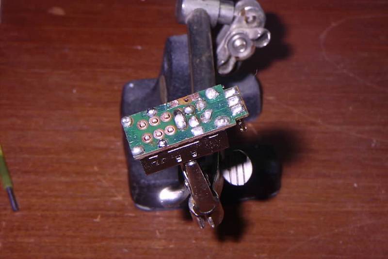

Ok, I pulled the switch, unsoldered my previous work and started over so y'all could "see" what I'm rambling on about...
The photos tell the story. The brand name of the switch should be obvious.

In electronics, the higher the sophistication of a part, the tighter the packaging of that part, and the less access we have for that part. So we are now at the mercy of the assembler/manufacturer.
We are all in the same boat. A higher cost for a part SHOULD mean a higher degree of design features, better components in the unit, higher quality control and assurance. The all in one switches made ALL our lives easier. They use heavier gauge wire, the plastic box is more substantial than the "older" flimsy looking designs. The perceived added value costs were also at least $10US per switch over the "older design".
The perception is (was) that there is $10US more of value. Unfortunately, that is not really the case here. The design is good... It integrated a need for us, the additional wire gauge sizing also is a plus too. The biggest plus was that instead of wires being soldered directly to a little switch tab, the wires were soldered onto a pad (larger area) on a piece of circuit board. This is also its weak point.
Let me explain...The entire unit is hand produced and assembled, what all of us have is personally crafted switch. The only automation there is the screw gun that attached the screws to the body, and even that is held in a hand. The soldering of the wires is done by people applying a drop of solder to the pad. The opportunities of manufacturing a bad part are unfortunately quite high.
1. Circuit board material is single layer glass. No problem. However, the manufacturer of the board may not use the best processes to assure quality traces. After all it is only a wire connection device...hmmmm.
2. The circuit boards piece that you see in the picture has been hand cut via pneumatic or electric scissors from a "mother board" that could contain a hundred of so of these parts. An operator could easily and accidentally nick or cut a trace.
3. Have the boards been cleaned of oil and crap. My guess is as good as yours.
4. Solder - They PROBABLY use solder appropriate for the job.
5. Assembly of the board - Here is where it gets interesting.
I used to teach new employees a 2 day course on hand soldering. Yup... there is that much to learn about the process and what it takes to do a good job and have consistent quality.
The easiest way to see a good quality solder job is to look at the soldering job. Is it bright? If so the chances are high that the bond/connection is secure. Is the surface dull? If so, the bond is not there and the connection though probably has conduction, it will not have so for long. Use these as indicators. If they did not use a proper flux on the board, the solder may be bright but it would look blobby. (yeah... I know that is a lame REALLY technical term.
So now the little circuit board is soldered, and the person assembles it into its casing. It has to be manipulated, with wires being worked and twisted slightly for the fit. The unit is finished. Total time for all of this... all the processes from start to finish including packaging is less than 90 seconds.
Has the finished unit been powered up to test for circuit continuity? Does the manufacture do any life testing? (hahahaha - I know my guess). Are there any destructive testing aspects conducted....
The cost of buying these switches is about $15 and up (depending on the features). The cost to the manufacturer is less than a buck. (I have an engineering background in automotive electronic mfg., along with 25 years of Asian assembly experience so this cost estimate is bang on). The rest is marketing, distribution related costs and profit. So waddya want for a buck guys?
I lost my favorite plane to a switch - because I thought that the price included some quality control.(talk about my OWN experiences not being listened to0 by myself, I still kick myself in the butt over that!!!) Now I use 2 switches and 2 battery packs on any plane over 20cc.

Thanks for the headsup!
I have the selfsame switch that was going into my Extra 330L!I opened the back up and had a good looksee![:-]
This switch is a whole lot better than the one in the comments.
Maybe it's from a later production run!
As you say, it's the little things that can re-kit one of our pride and joy!
Thanks again for the pix.

I agree with Pat about naming the brand name of the switch. I'm new to the bigger aftermarket switches and I don't recognize which one it is. I have 2 smart flys ordered that I'm installing in a new 35%er. I'll check them out first thing but still don't know which one you are talking about.
Something came up in a conversation today with RTK that has a lot of bearing on how well switches in general hold up.
How many people provide support for switch, battery, receiver, and servo wiring reasonably close to where any given wire makes a connection or exits an electrical "appliance"? How many provide for any type of strain relief in their wiring?
Permitting wires to hang loosely from a battery, switch, or servo places that wire and connection under tremendous flight loads as a plane is flown through any type of aerobatics. Leaving extension connections laying loose inside a plane, or wires left unsecured at the receiver, are under the same loads and subject to failure at any time. Wires pulled tight in order to stretch that last little bit of distance, rather than buying and using a longer one, place constant tension on the connections at both ends. That may be a battery, regulator, switch, ignition, or any other component.
Failure to adequately secure wiring can cause solder joints to break and foil traces to be pulled from pc boards of any associated component. Over a period of time various components and wiring should be expected to fail if left unsupported during flight. This is one of the little things that's rarely mentioned in aircraft set up and should be covered from time to time so we don't set the stage for flight failures through neglect. We need to take a hard look at our installations and consider how much movement is available to all the wires. How much weight will each bundle of wires be when subjected to aerobatics and how far can they swing? What will they impact at any portion of a swing? Will any of the wiring be pulling directly on it's connected end when subjected to a flight load?
Little things one by one but big in causing crashes.
