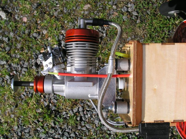

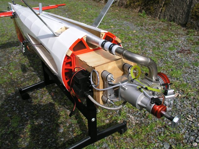

This engine vibrates less than a glow because it has electronic ignition which set the timing right.
And the backcover screws will hold I know. they are a little longer to the radial mont.
This will do
http://mvvs.nl/MVVS/photos/radial%2026%202.jpg
or do as I did.
// Lennart
This will do
or do as I did.
// Lennart
The radial mount is very strong, and can easily be ajusted fore/aft. Once you start using radial or back mounts, you will never go back to the clumsy "universal" mounts.
I even use a back cover plate mount for my .15 engines, set up on isolator mounts. Every single bolt of those M4 allen screws holds a ton of force, so that certainly is not the weakest link in the total force transmission train.

That is an extremely nice back mount system.
I see that you have no vibration compensation in your header. How did the construction hold during the long practice and competition hours?

Hi Pe.
I was a little worried about the header because its made of KS parts and very thin SS, but I have not had any problems
after two seasons hard flying. The pipe is only supported at the rear, and the rubber in the engine mount is very hard so the engine cant move.
Why I chose KS parts was because the have 22mm 90 degrees bends with only 36mm radie and I haven't seen that anywhere else.
The back mount is Sullivan, I could have used it as it was from the beginning but I got one from a friend who had drilled at the wrong places
and I wanted only the back part with the rubber, so I made it this way because I have used back mount on all my glow engines in the past and it worked.
I can only say that this setup has performed perfect and everybody at all contest and displays we have been at has been very impressed and surprised when
they are told that its a 26cc gas engine in that plane.

You did a good job. I too like the short-stroke, soft rubber mounts best.
They do not allow the engine to move much, but are very soft for the first 0.1mm and tight when deflexed more, which makes for a stable engine setup that still has good vibration isolation.
