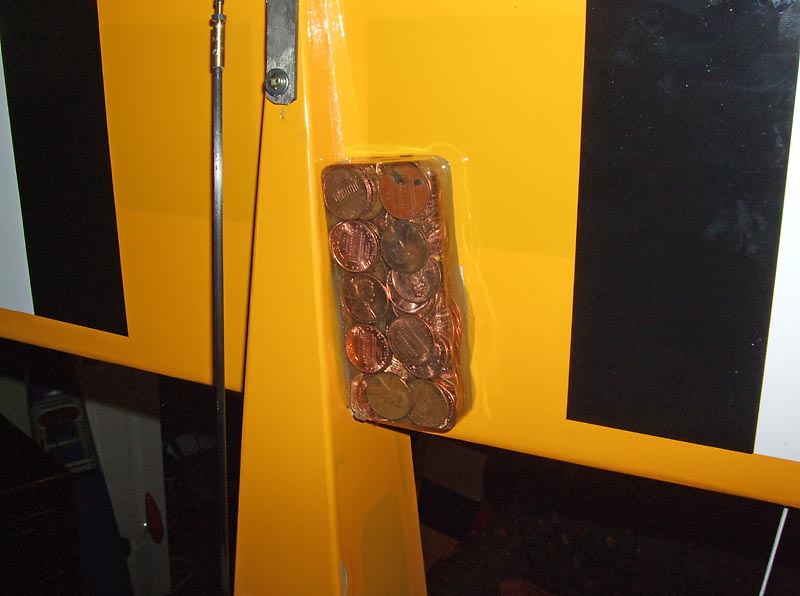

I also had to add weight to the tail, in fact 9.5 ounces, because of all the weight up front.
I put elevator and rudder servos in the tail as well, and crammed everything else as far forward or backward as possible to leave the middle bay open for the AV package which I will add later.

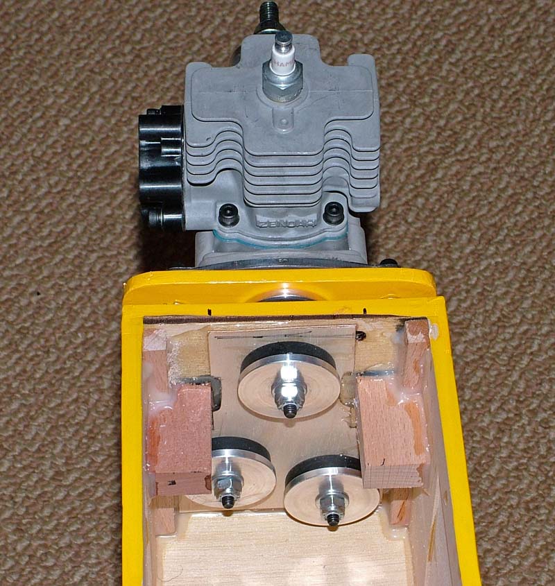

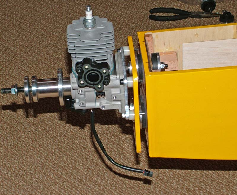

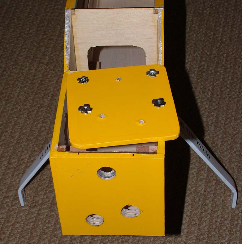

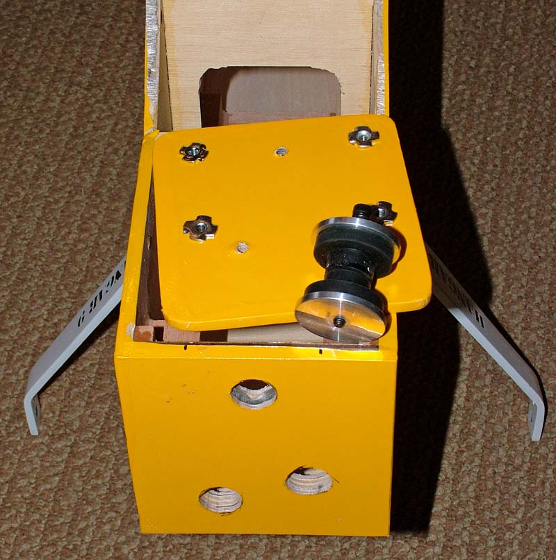

I don't know how others have done their engine mounts, but I decided to try an anti-vibration mount for the first time, on any kind of engine. It is the B&B Specialties "Vibra loc" and they were probably more robust that necessary for this engine, but I didn't clamp them down too tightly and I think they might be working the plane has very little vibration from about 3000 rpm on up.
Here are some photos of the installation. I used the main firewall as sort of a "sub-firewall" and made another firewall on which to actually mount the engine. I used 3 of the "Vibra Loc" fittings (mainly because that's all that would fit!) and I staggered their locations - with all three sides unequal - in hopes that this might help attenuate the vibration a bit more.
I don't know, nor do I claim, that there is any validity to this approach, but the vibration levels seem quite acceptable.

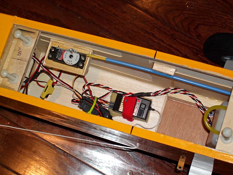

So with all that extra weight up front, I knew I was going to need a SERIOUS counterbalance in the tail. So I figured out how much weight I would need, used some pennies and epoxy (all weighed separately) and used a small plastic nail box as a former to make a "brick" of pennies. I have since spray painted it yellow and it doesn't look objectionable at all.
#43
RE: Gas engine for Senior Telemaster
I was wondering if the gap between a plate on back of engine and the firewall was filled with a good quality of silicone rubber, would cut the vibes down some. Four small safety bolts could be placed through the "sandwich" in case the rubber let loose. Seems like it should work on engines up to around 26cc. I guess it could be done on a test stand first. Capt,n
Well, at this point I'm not going to change anything... because it's all working well. Maybe next time!
I think the vibration thing is working because the vibration feels like that of a .25 glow engine, so I'm satisfied with it. Could I have done better? Hmmm....

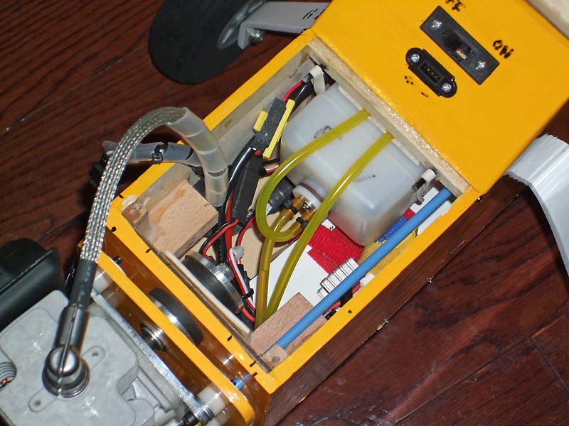

The goal was to stuff all the propulsion-related items as far forward as possible to leave the area around CG open for the A/V payload, so shortening the nose was not an option. You can see from the photos that I managed to get the gas tank, ignition, ign switch and recharge harness, 3850 mah ign battery, 5-volt regulator pretty far forward. Only a small portion of the tank protrudes beyond the former.
I would have put the throttle servo up there if I could have crammed it in. But in order to preserve that space around the CG, I decided to move it pretty far back. Works fine there.
Now if I can just get the A/V stuff to balance on CG.

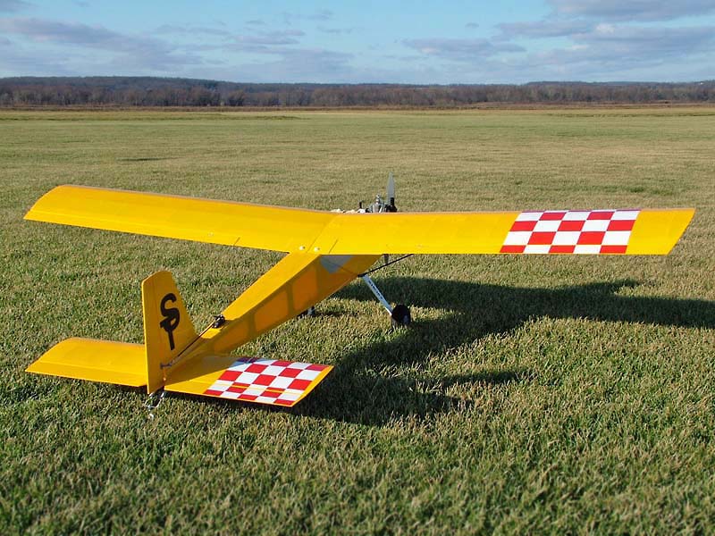

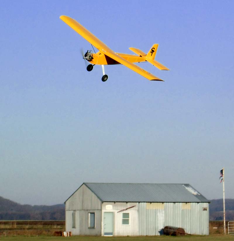

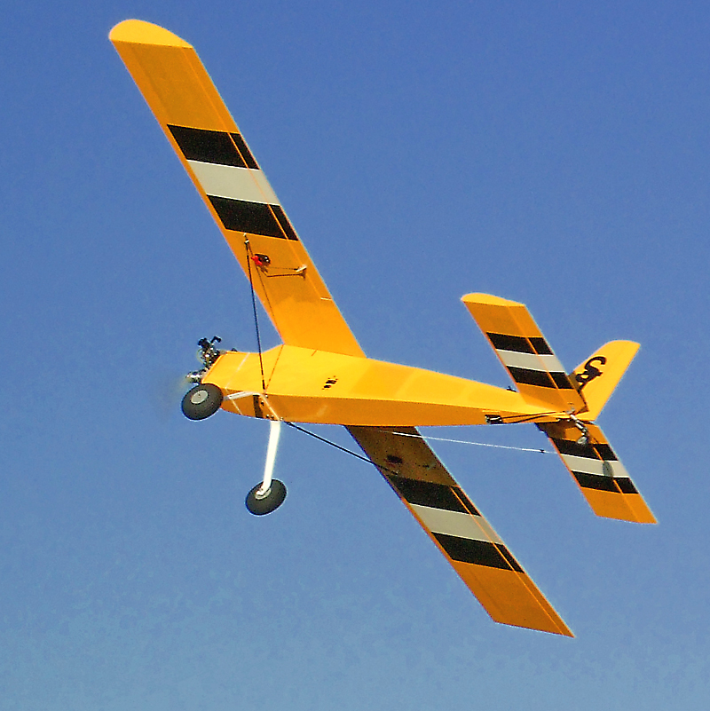

Great day to fly Saturday, and I had it all to myself. High was 30 deg F, but it wasn't too windy and I know how to dress for the cold.
Got in 3 more rather long flights and had a ball. With all the extra weight from the vibration fittings, the extra-large batteries, 9-1/2 oz counter weight, etc., mine comes in at exactly 13-1/2 lbs!
What blew me away was that it would hover absolutely stock-still with the G20 and the 15x7 APC!!![X(] I will get someone to video this for me next time I fly it, and also inverted flight, which is also very good and came as a shock to me.
