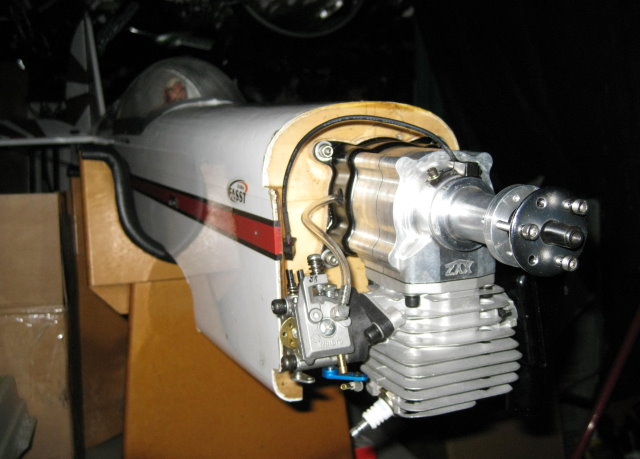

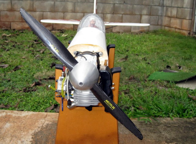

hi bob...thanks for pointing that out...lesson learned...my analog hs-645 tail servo was dancing to the tune of my ignition...i swapped the rudder to ailerons, and the rudder was still dancing, while the ailerons were solid...so i repositioned the ignition wires away from the radio wires, and replaced the hs-645 w/ a digital hs-5625 that needed a home...now the rudder and other controls are rock steady...only problem, i don't know if repositioning the wires or replacing the servo did the trick...lol...i'm still looking for a local source for bpmr6f plugs...ken
