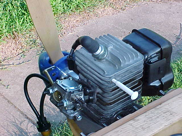

Default Turkey testing doohickey
Two tanks of gas and mines not done yet
Sorry Sam, we're just funning a little.
