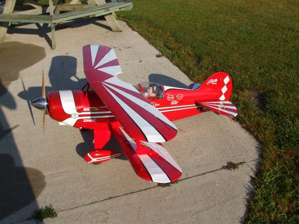

WM Spot On 120 flight ready:

Looks like your gaining about 120 rpm per cm of cut header. As long as your in this range per cut you can go a bit more. When the amount per cm starts to drop then quit.

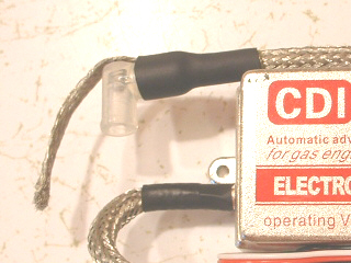

As you know, Ive been using the RCExcl ignition for glow plug thread and 1/4-32 spark plugs.
These are not the best options for reliability as the silicone plug boot keeps sliding out and results in an arc between the boot and the spark plug head. - HUGE RFI!
to overcome this, Ive put a couple of layers of heat shrink on the boot then used a thin wire to crimp the boot in place (without damaging the silicone underneath)
It works for now.. But Im thinking about modifying the 160FX head, to accept standart 10mm CM-6 plugs.
But before doing this, I wanted some feedback. Would the head have enough material, do i need to make other mods other than enlarging the hole to 9mm and tapping with M10 tap?
Would it likely fail in flight? any ideas?

I always wanted to do this to one of my 160fx's and compare the performance to my Evo 26. It looks like you are getting nearly 1000 rpm more out of the OS! The 8700 rpm quoted by Horizon for the Evo is with a tuned pipe and low load Mejzlik 18X6. The glow 160FX spins that prop at 10,000 rpm.
My concerns for long term use would be the wrist pin seizing in the piston and faster wear on the crankpin and con rod. But then again gas has better lubricity than methanol so maybe the reduced oil won't hurt anything. You could add a couple oz of castor per gallon for additional protection or run Pennziol at 8:1 vs. 10:1.
Too bad nobody makes a sheilded McDaniel Style twist lock plug cap for the ignitions. Installing a cm-6 plug will change the chamber volume and lower compression.

If it were going to sieze or show signs of wear and performance drop, i guess it would have shown it by now.
Ive run about 4 liters of 8% oil mix thru the engine doing hard vertical 60-100% throttle pattern manuevers with the setup (picture above). And its still incredibly oily inside and a little out. I wipe the oil after every 5 flights with a single small paper towel.. and most of what I wipe comes out of the carb venturi.
It would be like heaven if I could get my hands on those locking type plug caps for these small spark plugs. I use the ones I bought from Just Engines UK for £5.. not that pricey!
So CH ignitions have these locking plug caps in stock? I thought of buying a locking type glow driver and cannibalize it to manufacture a locking type plug cap, but seems like a lot of work.
This way or the other I need a locking plug cap for reliable operation and it would suit me better if I didnt mod the original head.

The CH cap can not to added to a lead. We have to build it on the lead. You have to change the entire lead. The plug lead on most ignitions is not replaceable.
The CH units with aluminum boxes can have the lead replaced. The cap and lead is $14. and the spark plug $18
