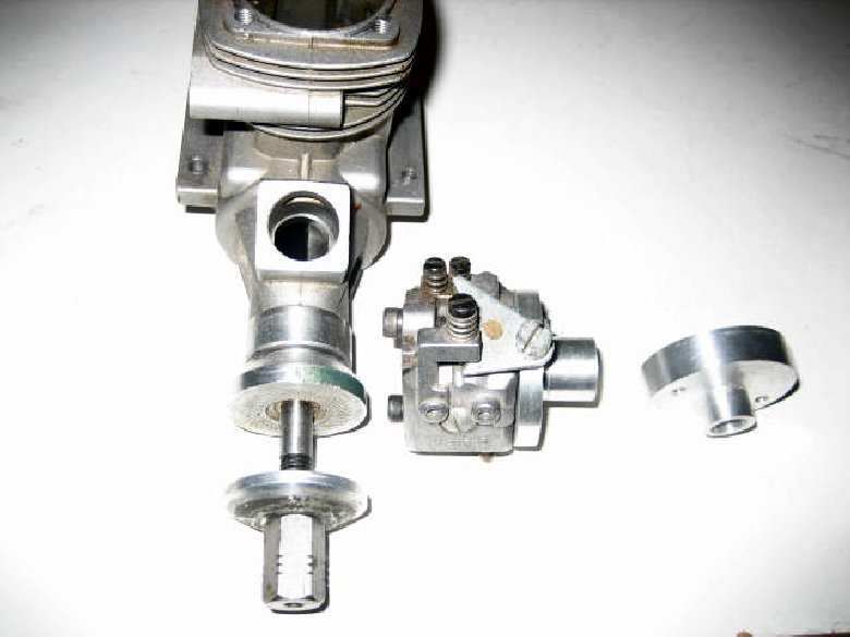

Ok Here's an update on the project:
Im going with a walbro carb conversion for this project, as it has a diaphram pump and regulator on it and meters easier than glow carb.
Actually Ive run into a problem today. I received my package of walbro carb, gaskets and adaptor flange for EVO26.
The flange has a 17mm outer diameter throat and 160FX has a throat of 15mm. so unfortunately its not a bolt-on fit..
The good news is the walbro carb clears the thrust washer so it wont be a problem once I sort out the adaptor flange.

Heres a pic of my engine[although its not an OS],but this post does deal with the adaptor.I made the adaptors on my lathe.The carb is a 8-9 MM i blieve.Its the same size as the throat on the aaptor,maybe a little larger.
Anyway,its a WA59 and believe its off a 31cc weedie.The reason i like it is it has the stubby needles with the large screwdriver slot,and it has the large triangular shaped throttle plate for an easy hookup with at least to different styles.You wont find the number but it has a 20 stamped in the throat.All small walbros use the same distance on the bolts.You can use any carb you want.I looked at a couple i have here.The one that i would suggest first would be a WT160-B.It comes from small stihl power equipment,weedies.
The one adaptor on the right of the pic is one i made for my ASP .91 but i learned that ABC style engines wont work right and that i needed a ringed engine.So in short conversation,thats an extra that im not going to use.Im going to send you a PM.The bottom dimension of the adaptor is 14-15MM.Its already drilled and tapped for a walbro using 8-or 10x32 bolts.You cant really see it but the back side of the adaptor is flat so it will sit close to the cylinder with out hitting it.Im just posting this info so it might help.
OOOOOPPPSS!Here they are.

Thank you for the offer, but Im going to visit a friend of mine tomorrow, he has a lathe workshop.
He will make 2 new copies of the original EVO26 GT flange, which will fit the 160FX venturi opening. I'll shoot some photos and upload the conversion images here.
hopefully I'll try the walbro carb on saturday.

OK, here is a basic conversion for EVO 26 Gasser engine Carb flange to fit the 160FX.
The original flange:
I drilled out the original flange with a 15mm drill bit:
Then I cut away the remaining throat with a metal saw on the drill bit:
I cleaned up the remaining burr with a sanding paper dremel bit:
Now its time for the new 15mm throat.
I bought a piece of 15mm OD and 13mm ID stainless steel pipe.
The reason I chose steel was the tapping would be more durable than aluminum as its only 2mm at each end.
And the 17mm long steel throat gets into the carb flange throat nice and snug.
There is no easy way to bind aluminum to stainless steel,
so I mixed up a small amount of Devcon Steel epoxy (same as JB Weld) and applied to the joining surfaces.
A small amount is more than enough to hold them together and seal for any airleaks.
Then I positioned the flange on the engine, marked the places to be tapped for mounting the flange on the engine from sides, then drill & tap away.
Its important to mark the points to be drilled before putting on the O-ring as it should crush between the engine throat and flange; and seal nicely.
Unfortunalety electricity went out last night because of the storm, before I could finish the job. I couldnt do the back-plate tapping for pump pressure. No trials today..
I'll finish up the back plate pressure fitting job asap and hook up the walbro carb and give it a try in a couple of days.

What was the OD diameter of the stub on the original evo adaptor.
Old 11-24-2008 | 03:29 AM
  #49
liquid_TR's Avatar
Joined: Apr 2007
Posts: 730
From: ISTANBUL, TURKEY
Default RE: Walbro conversion for OS 160FX
OD was 17mm. ID was 13mm. If I had turned it down to 15 by lathe, It wouldnt hold enough material for a screw.
