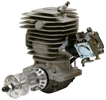

I picked this baby out of mud from near the lake side I fly at.
There is no brand what so ever printed on it, as far as I can see. The carb is a walbro and the ignition is a CH ignition unit that says "made in USA".
I cleaned it out with water and now its cooking in the antifreeze bath. Once its clean enough I will dissasemble it to see if I can salvage it or not.
Even if I do salvage it, I wont be using it on a serious airframe anyway. Just a fun and free project.
Does anyone make out what brand and model it is from the pics?
Here are the shots:
Thanks!

BME something?? Not sure though.
Old 11-23-2008, 02:53 PM
Join Date: Feb 2002
Location: Valley Springs, CA
Posts: 18,602
Default RE: Please ID this engine
Echo based. Possible 44. BME used the design, and a CH ignition, but I'm not certain of the prop hub. If you get it cleaned up and the crank is in good shape you'll have a good engine.

It is a BME for sure. What really gives it away is the lightening of the prop hub. It most lickly is the 50CC Classic. Although they did make a 40 something sport version Too!

I was going thru BME engine photos as suggested, and found this:
I guess its a match.. BME 50 Classic?

same hub and same number of fins as the 50 pic, id say a 50cc bme for sure, but thats a guess.

Well I tried to clean up as much as I could, but this engine is history. The crankcase is corroded - fins crack and break like biscuits, all the screws are corroded beyond repair - cant open it up.
I can see the inside from the carb opening and the conrod is fubar. probably so is the crankshaft, conrod needle bearings, normal bearings.. the carb is beyond repair, I would have to buy a new one.
I tried to get off the muffler but one of the bolts broke so I drilled it out with a same diameter drill bit but the muffler is basically welded to the exhaust port - I couldnt remove it even with a heavy plastic hammer..
unfortunately the cost of repairing and restoring this engine is no where near logical.. Its probably been down in the lake for over 3-4 years..
Its kind of "case closed"
