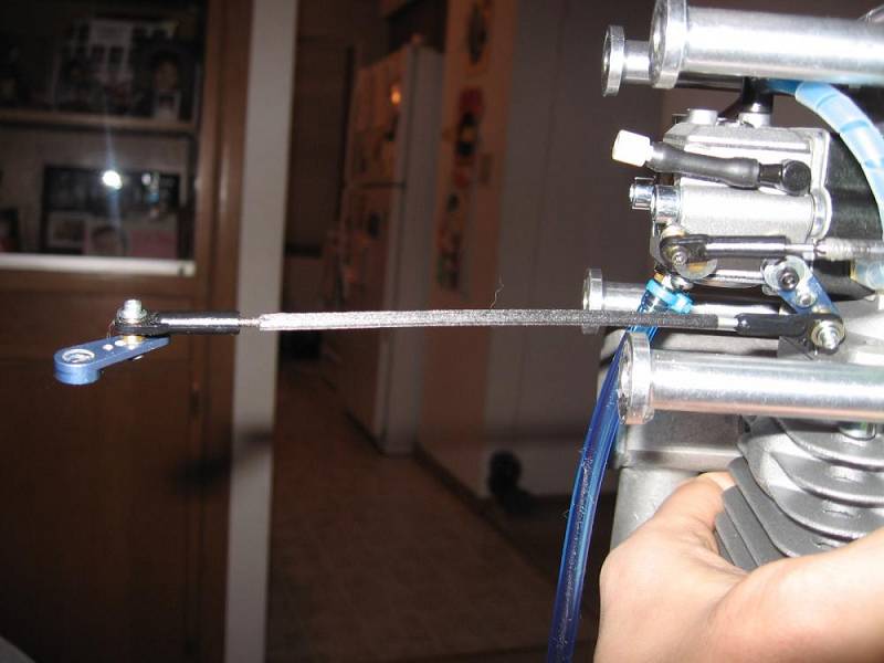

First I'd like to see pictures of your thottle linkage at full throttle and idle. After that I'd start looking at the transmitter programming.

I have found the easiest way to set up the mechanical linkage is to set the servo arm pointing straight down the throttle pushrod at fully closed (stick and trim fully back), this will give a good starting point for fine tuning the curve if neccessary.

Here's a post I copied from another site that I made last night. The picture of the engine is shown with the linkage at idle.
What I try to do is max out the end points and use the closest hole on the servo arm and furthest hole on the DA throttle arm to get full throw of the butterfly. I always have my servo arm at a right angle to the servo case with the throttle butterfly at 50% of its full rotation...at half throttle stick. This usually gets me a very good feeling thottle using all the of the transmitters resolution (full ATVs). It makes the throttle feel smoother.
I attached a picture of my DL-50 that was setup on my 30% Edge (going into my new 30% EF yak). This setup used Hitec 1 inch arms with the 4 holes in them on both sides. The push rod was on the 2nd hole closest to the servo, 3rd hole closest to the throttle shaft. I think my end points were not far enough out though. Only about 100/100 out of 140/140 max. I really should have drilled a new hole in the middle of two on one of the arms but was too lazy.
PS: Also ignore that 1st hole closest you see on my servo arm, I drilled that one myself. The pushrod is really on the 2nd hole. not the 3rd (and someone always catches the stuff that doesn't make sense in my posts).
Agree with getting it right mechanically before using the radio. But we're all ASSuming he has it fouled up right now. Haven't seen a pic of his setup yet.
I try for linear stick to butterfly movement. Meaning if my high endpoint is 90%, I will adjust the linkage until my low is also 90%. I want the same throw on the top half of the stick as on the bottom half. In a perfect setup, it would have 100% throw in both directions. But that doesn't always work out. Seomtimes 100% throw is too much movement. So that's when I pull the servo horn off and move it a spline or two. Then adjust the length of my pushrod. I'll settle for 90% high and 90% low. You suffer some resolution, but at least it's linear.
It's a shame really. Computer radios make some of us lazy. Some guys have no idea how to really set up a linkage with best mechanical travel and actuation. They just dial in 25% on the low and 150% on the high. Then they wonder why all the throttle response is from 1/2 stick and below, but not much throttle change above 1/2 stick. [
] It all comes back to basic modeling skills and experience. Two things that have gone by the wayside in recent years.
Call me anal........ I'll spend 2hrs futzing with a throttle linkage to make sure it's set up mechanically as good as I can get it before I even consider adjusting the radio endpoints.

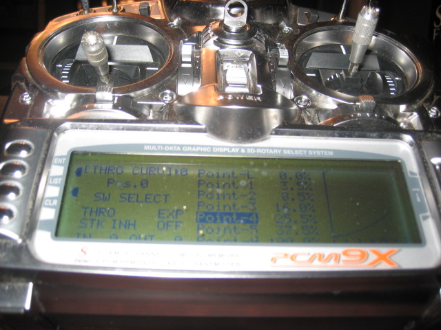

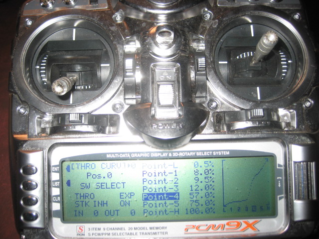

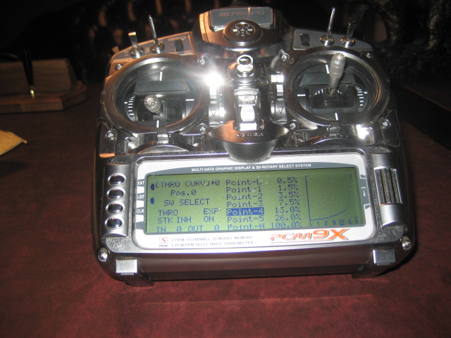

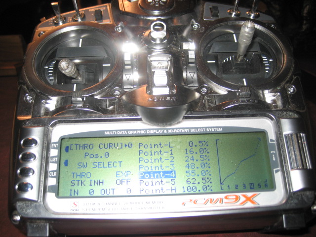

Hi my friends!!!
Well...finally and after several weeks of no flying because high winds here in central México, here is the conclusion with photos:
1.- The original linkage.- It was made of a weak glow clevis and a very thin link. That wasn´t the correct form, the result; the link is twice and the throtle answer was inconstant. At the middle of stick, I had almost al the power.
2, 3, 4 & 5.- The original linkage was replaced in the engine; by a DUBRO ball link, a more strong rod and, in the throtle servo, with a heavy duty single square link.
In the airfield, I adjust to parameters; the first.- the ATV´s at 85% in rate A, and 85% in rate B. the second.- with the tachometer showing 1500 RPM in ralenti and, 7000 in top power, I adust the exponential curve between the 13 points (photo 6).
The results was succesfully (with a Top Flite 22x10 prop):
1/4 of power at 25% of the throttle stick, 50% at medium, 75% at 3/4 and 7000 RPM´s at full.
To the final adust the throttle curve, I had to fly 3 times. The showings in land, are not the same feelings that in the air, for example; at the middle point, the tachometer shows 3500 RPM (usually 50% of the power), but, in the first flight I feel the middle of the stick so weak. Because this, in land I had to move a few of the parameters.
Again, thanks for all your suport. Without your help, I never can set correctly this.
The plane now is flying great. I had no problem with the mixes; rud to ele, rud to ail and ele to thr.
In my new proyect, I also use the information that you helped me. It´s a GP Edge 540 27% with a DL 50 cc engine. I have started with the mechanical procedure and, the next week I will testing in the airfield and set the radio.
Good bye, and see you soon!!!!.
Sincerely.
Pedro.
