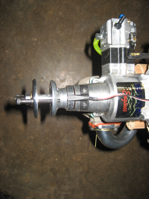

HI GUYS,
GOT A BME 105 WITH THE 110 CASE TURNS ABOUT 6100 ON A MENZ 27X10.
WANT TO GO TO A VESS FOR 3D ANY THOUGHTS OR EXPERIENCE? 26B? 27A?
ANY HELP WOULD BE GREAT THANKS
BRAD

Default RE: BEST VESS FOR A BME 105?
26B the 27a will bring the rpm down to about 5500
most def a mezn is shorter than its spec, your menz is barly 26.xx inches

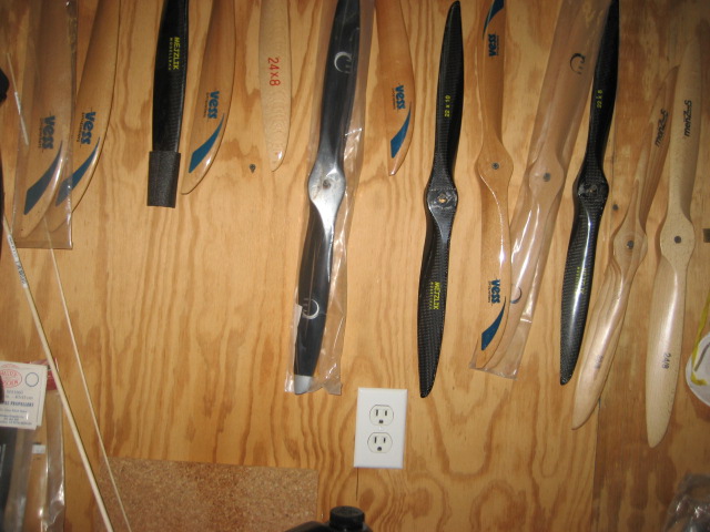

i dont have any for sale. I like to make sure i have plenty of various sizes as i have 6 gas motors so that way I can find what works best for my needs/per the airframe. The numbers should be in the 6300-6800 range depending on your set-up and motor condition/exhaust..... The B pulls very hard even at lower rpms the 26A is for all out 3d or a very heavy airframe......

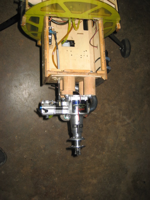

great, its on a qq 101 yak only 25lbs w/smoke! because it' so lite that's why i thought a 27a might work
it will fly it and pull it around quite well but 5500 or so is out of BME best rpm range that is why i say stay with a 26.
