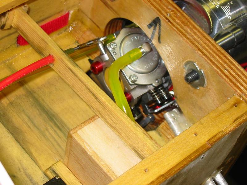

Update on this : Last weekend I flew with a "balsa box" and it seemed to make no difference at all. Pics show the backplate I ordered from DA which has the nipple and the box.
I put a coat of dope on the box and now I think maybe that was a mistake (it should breathe "slowly" to allow changes in weather and heat so as to not form pressure I think). I went to about 800 feet high, rolled inverted, dropped to idle and held full down elevator for about 8 seconds. Then I gunned it and it abruptly quit.
Anyway, I need to try the baffle idea next. This box was easier for the time being as I needed to do maintenance on the muffler and smoke system anyway.
BTW, a friend with the same problem tried using a small 2 oz header tank with the same sort of arrangement and he said his motor wouldn't run with the line connected. I think maybe he did have a pressure build up but I can't prove it other than his ran "normally" when he disconnected the line. With the line on the header tank to the diaphram nipple, his engine sounded rich to him.

Nice set up but one thing I see that I don't think is going to work.
Is the tube hole in your box needs to be larger to allow it to get air in it. also where you doped the box that will stop any filtered air from getting in , Myself I don't think even a undoped box would allow enough air to get in with the tube as tight as it appears in the pic. A person dosen't want a tight fit on the tube, I use a pill bottle with the cap drilled for the tube to fit with slop and tie off the tube so it can't come out. All this is doing is moving the hole in the plate away from any high or low pressures the cowl or wind might make on it, in other word its a shelter from the pressures or wind.
I have seen several that just went to the inside of the fuse and ran fine, No box or bottle, However I like the pill bottle myself. I have heard of some going as far as the use of a condom in a bottle to get a air tight seal that allows only the air within itself to operate the diaphram I think thats going a little bit to far.
Cyberwolf, so let me get this right you're saying that the box needs to "breathe"? Well, I definitely did not allow for that as I sealed the tube to hole in the box with Goop, and doped everything.
I honestly don't notice any difference in this setup vs the stock hole in the backplate. I've flown it 2 weekends now. I would have expected some tuning diffs, but it seems to run fine except for the inverted stoppage at idle of course.
What if I got rid of the goop on the tube, and then poked some pinholes into the box? I thought the point of having the wooden box in the first place was to give a reservior which was immune to (abrupt) pressure changes inside the fuselage? I chose balsa because I thought it was important for it to VERY SLOWLY acclimate to pressure changes caused by weather and temperature differences (ie, from the basement to a hot car to outside air for example) a balsa box would allow that due to its porosity while a sealed bottle would not. I'm thinking poking holes would defeat the purpose of the box in the first place. Maybe only 1 small pinhole would do it?
One should keep in mind that in my plane (TOC Yak 33%) the pressure seen in the cowl is probably very close to the pressure in the entire fuselage as the firewall and engine box bottom have been cut to clear the carb and other installation features. The carb really isn't IN THE COWL as it sits so far to the rear and is exposed to the same air as my box. The cowl just serves to scoop all the air and at one point I convinced myself it ws causing a problem when inverted due to a wierd turbulence situation due to the angle of the incoming air and the orientation of the motor/carb etc.
When you installed your bottle as you say, did you definitely experince the inverted idle stoppage and see it cured by your installation?

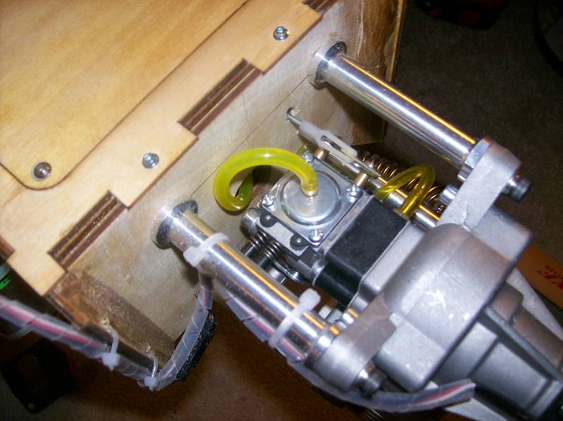

My set up didn't change the tune at all but allowed the engine to run in any direction W/O any issues. The Yak cowl & Suk cowls are the worst for air currants from what I have read, But my extra sure needed one, ran fat as all get out in a K/E one way only and sometimes in midrange depending on what I was doing The bottle stopped all that nonsense.
From what I have read and experenced myself, the bottle with a slighty larger hole for the tygon tube has worked well for me. The diaphram does need a certain amout of air pressure to operate, all your doing with the box or bottle is limiting the drastic change from low to high to obtain a even pressure for a level constant flow of fuel.
I put my bottle in the fuse with the opening facing the rear of the plane, so it will block any wind coming in from forward movment and it must stop any turbulances also both the planes I have done this to runs super in any position.
A few guys are cutting the springs also to help pressure issues and adding velocity stacks for less puddleing. So far I have not needed either of those mods.
Good luck
