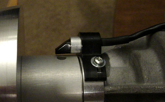

Old 06-14-2003 | 11:30 PM
JohnVH's Avatar
My Feedback: (38)
Posts: 16,179
Received 10 Likes on 8 Posts
From: Ferndale, WA
Default problem with my zdz80
here is how mine is
