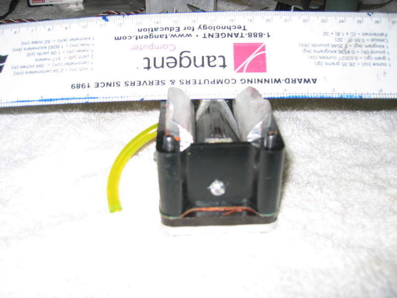

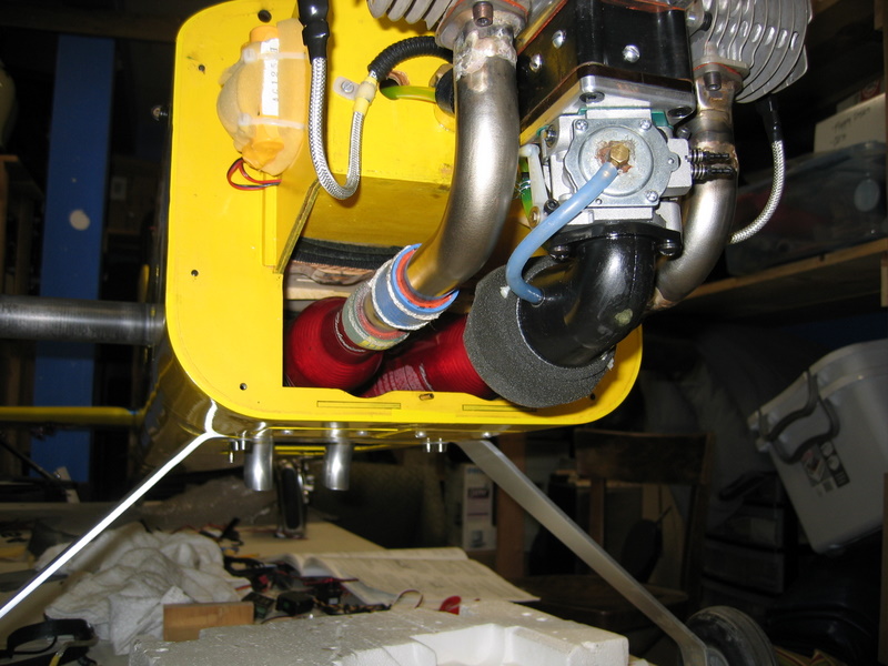

Mine continues to amaze me with how nice it runs now all the Carb kinks are worked out. Transition from low to high is as smooth as it gets and the power is way up there where only BME can go. When I first dialed it in and tached it, I had a 27x10 NX or Xoar prop on it and got 7400 static. I ran that prop as long as I could getting some time on the engine but I found I let it rip too much cause it just sounded too cool. I've run it quite a bit with the 28x10 PT but that prop really loads an engine and I feared I'd get careless one day and hurt the engine pushing it too hard. Now I'm running a NX 28x10 and getting 7130. It will rip the prop on the way up from a hover. Pulls the plane around without straining.
here's a few pics.
Home made Canns. There's a thread here how to make your own http://www.rcuniverse.com/forum/m_73...tm.htm#7385806
Home made Reed block stuffing, cured almost all the earlier problems. I have a BME reed block fix piece and it looks like it will work as well. I'll try it on my older 115 in an Extra.
And the plane it's in. I'll try to always have a Katana around for their clean flying abilities. Pilot is making the exact same plane for those interested.

The new reed blocks that BME is using with the 116 eliminated the need for the stuffing plates. I have one of the new aluminum reed block versions which appears to be a little less in cavity area than the new plastic one. Hard to tell though. I don't know which of them is being incorporated with the new engines but either of them cured the problems the early 115's had.

If you come across one of the original 115's you can obtain a new reed block and wga 7/9 carb from BME. No cage stuffing required. That's what was done with mine and quite a few others. Fixes them right up

Yes, But it's a SD Katana. Find a 115/116 and don't look back. I have a plastic reed block from The new owners and it looks like it will do the trick. If you find one there's a couple things I suggest doing like adding the AI snorkel and re-locating the diaphram vent tube to where mine is. And adding a very tiny hole to transfer puddled fuel back into the flow. Toss the head gasket so the lower ring doesn't travel so low it digs into the intake bridge. Thats about all I did to mine, other than the home made reed block stuffings.
The Katana goes up like a missle and you can blip the throttle and rip any time you want.

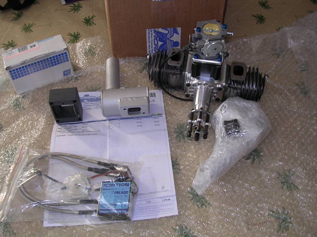

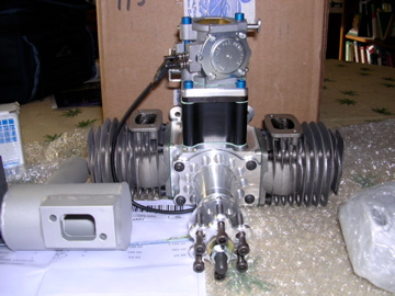

Can anyone on here tell me which carb is on my early 115 extreme? and do I have the correct reed block?

Default RE: BME 115 Performance

that looks like the newer block that BME sent me years ago. i think those came with a WGA 7 or WGA 9 if i recall correctly.... what r u going to put that beast N?

The early 115 had a WB-25. It's so noted on the side of the carb. Later versions have a WGA-9. Also noted on the side of the carb. Look for very small stamp lettering.
Send some larger pictures to BME for Tom to tell you what you have. Externally the reed blocks look the same.
