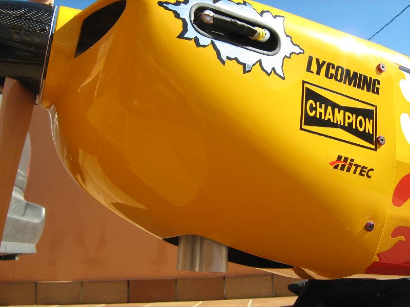

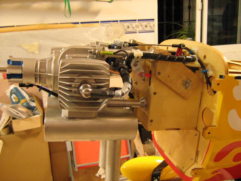

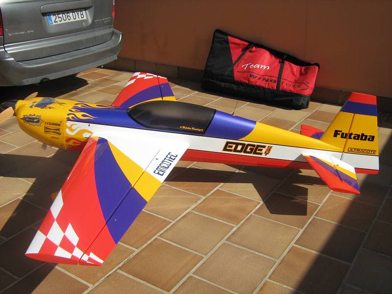

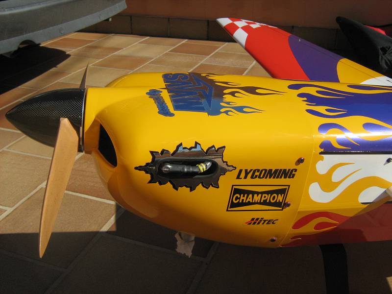

Default RE: 3W-110 vs MVVS/Evolution 116
I have a MVVS 116 (Evolution 116 in USA),is a beast and run very easy,with a Menz´s 28x10 run at 6.350 rpm with a Bisson pits mufflers(only 535 grms of weigth),with a Mezjlik 28x10 I´m sure to run 6600 rpm or more,the transiction is to real time!!,with the canisters run a Mezjlk 30x10 to 6100 rpm and move with autority a 3 meters plane.
Not to be picking on ya, but those numbers on stock mufflers are just average for that displacement.
