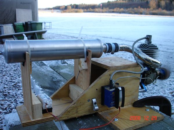

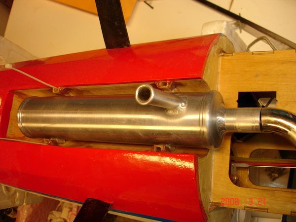

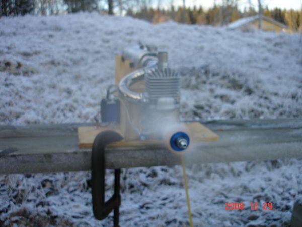

Hi!
A 24x8 prop is too small!
My 45cc MVVS (Evolution in the US) turns a 24x8 Mentz at 6600rpm using the small MVVS 3206 cannister silencer.
