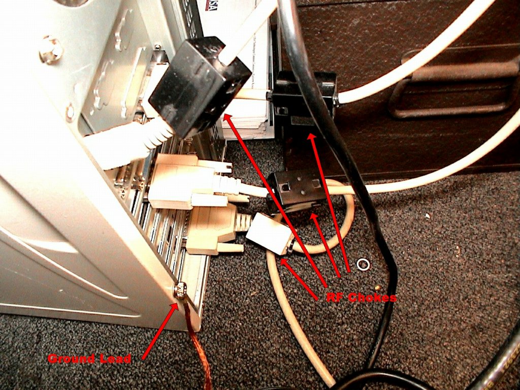

I would use a choke / rf filter on the throttle servo lead That has helped me out a few times. Ernie

Warbird72!!! When you said, "I would use a choke / rf filter on the throttle servo lead That has helped me out a few times. Ernie" do you mean one of those farad beads(sp), (you know those round cylinder things that you would probably see on laptop computer power adapters) Something like this: ( i should have attached a picture for you so you know what i'm talking about.)
