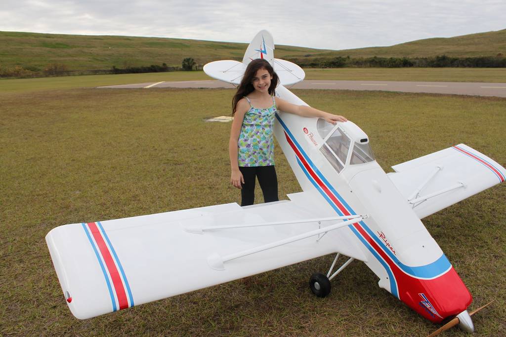

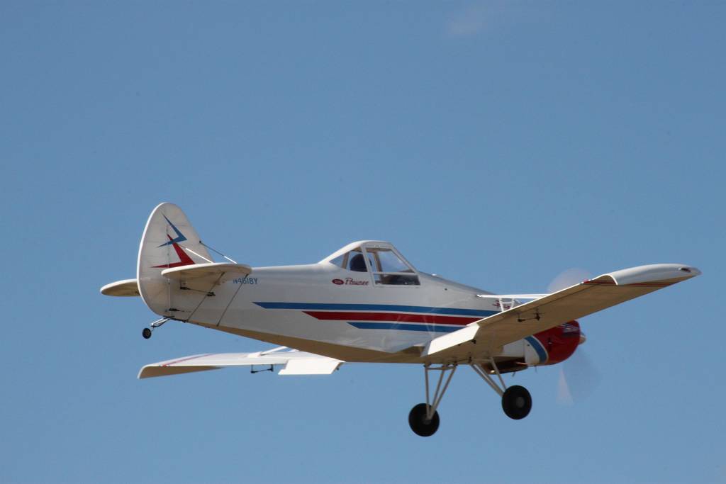

I moderate the heli forums but I fly a little of everything. Gliders, gassers, helis, electric, nitro and gas.
This stuff is mine and the Pawnee is the latest review project that should be going live in the magazine section soon...
I fly out at Jax RC but I belonged to Gateway for a while and lived in Fruit Cove.

You can even see the mountains of Florida in the background?

Eh....sorta.....those are land fill mounds
The biggest mountian I know of in Florida is Space Mountian. You can watch your dog run away for hours from the porch steps.

15 miles west of me there are some hills like that. They are the Crawford County Land Fill.

The Ravines have elevation changes of 75-100 feet
