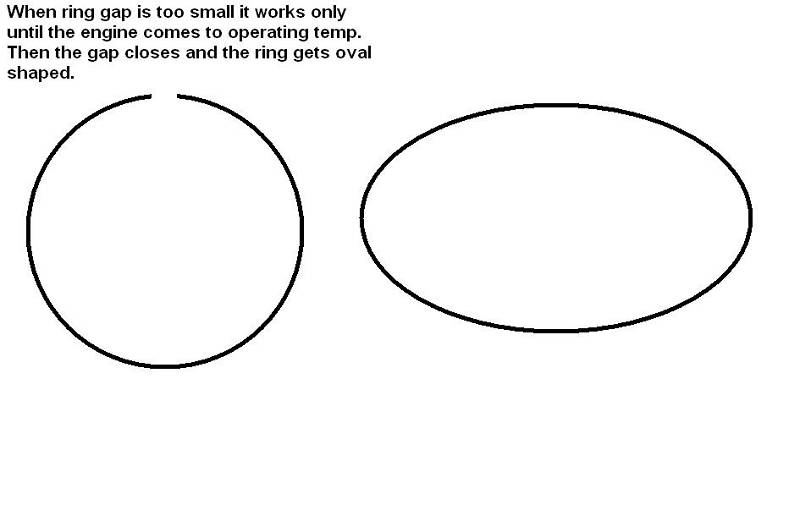

as far as the ring gap, the ring is iron, the piston and cylinder are aluminum, the aluminum will expand a lot more and faster than the iron ring will, so a small gap shouldn't hurt anything.

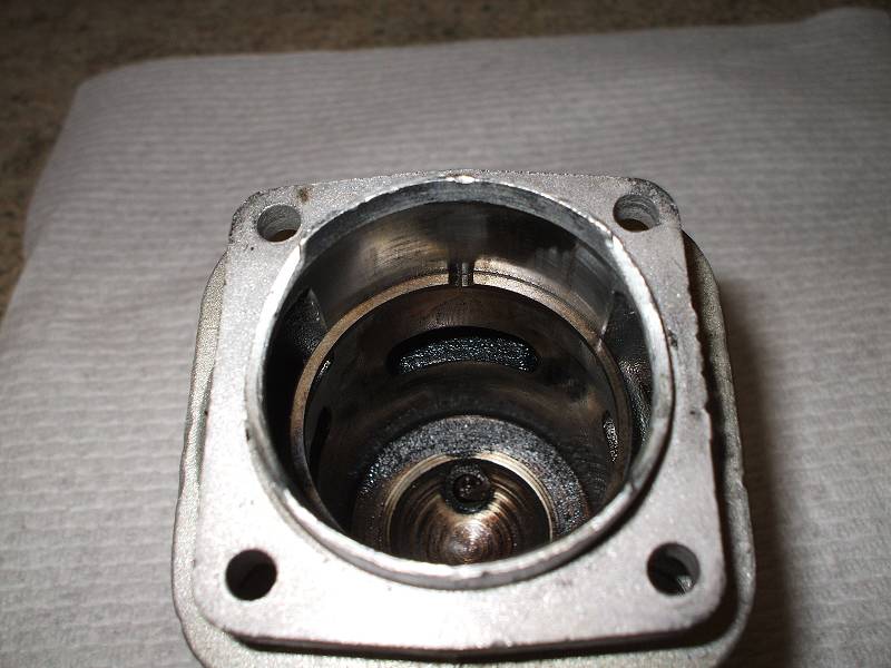

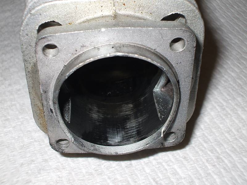

Old 06-09-2009 | 08:12 PM
  #37
Joined: Oct 2003
Posts: 122
From: Lucama, NC
Default RE: Low Compression ???
I hope the following pictures tell a little better story. You will see one that shows the shinny marks I talked about. You will see one that shows the ring end gap (I tried the ring in several locations in the cylinder and the end gap stays the same). This is a cheap camera and thats about as good as it gets.

ORIGINAL: rangerfredbob
I understand what you are saying. But don't forget the ring doesn't always fill the entire ring groove. There is clearance behind the ring....... between the inside of the ring groove and the ring. The gap still needs to be large enough to prevent the ends of the ring from touching when the engine is at max operating temp.
Yes, the aluminum piston and cylinder will expand more than the iron ring. And you would think that would provide all the clearance needed to prevent the ring from binding up. But you have to consider the ring IS going to expand. Not as much as the aluminum, but it WILL expand. As the metal expands, the ends of the ring will get closer together. The ring gap will decrease with heat. Thats why we need more than .002" . It's not because the ring will expand out and hit the aluminum. It's because the ring will expand and the gap will close up. Once the gap closes up completely, the ring will start to get oval instead of round, as it continues to expand. [X(] Then it goes outward and hits the aluminum cylinder and creates more drag/friction in a few hot spots instead of even pressure on the cylinder walls all the way around the ring.

Looking at the photos posted, that ring gap looks quite a bit larger than .002". If the gap is as jagged as it looks in the photo(not sure what I'm seeing there), then maybe a .002" feeler blade fits, but the real gap is larger.
Ring gap only needs to be big enough for the hottest ring temperature and coolest cylinder temperature it will experience. The problem is unless you are shooting for a small gap and actually looking for signs of the gap being too small, it makes no sense to try to get an extra 50RPM this way.

My 2 cents.... .002 thousandths is about right I think for that size of bore. The gap can be more on larger dia rings. I still say for the price of a Boman ring...it is worth a try. So far every engine I hand cranked with a new boman ring had real good compression even before runing. The last 2 was a ZDZ 50 and a Webra 1.2. The Webra fom new did not have much compression at all....dykes ring. It sure has compression now!!! on that using 320 grit. I would not do it. Some grit can embed cyl wall in some cases. Then what happens is fast wear. Now it seems like if you place the ring in bore and measure the same .002 in many places....the bore must be close to round and plenty usable. Get that Bowman ring...and find out for yourself. Not much to loose. Capt,n

Since there's no obvious damage other than a few scuff areas in the bore and the ring seams to fit fine down where heat doesnt get to, the probable cause for all the compression loss is the blackend area around the exhaust port. That area might have warped out from running hot. We don't know if DL runs their parts through a heat soak process before honing the bores. So it's very possible the cylinder warped out of shape at some time. Run another 10 or 20 gallons through it and maybe it will get better. Can't hurt.
PS. The Amsoil appears to have protected the parts quite nicely. Run some SeaFoam in your gas mix and maybe it will clear up the Carbon. Again can't hurt.

.002" ring end gap is normal for the DL when new and will no way close up and force the ring out of shape. As Captn mentioned even a .001" end gap would work fine. The pictures of the cylinder look fine from what I can tell but the position of the ring for checking it's end gap on an engine with that much run time is all wrong. In the picture the ring ends are on the exhaust side of the cylinder, the ring endsshould be positioned in the same location and orientation as it is when running, on the intake side of the cylinder and with the antirotation pin relief towards the top of the cylinder. It can make a considerable difference in the measurement especially on an out of round cylinder.
