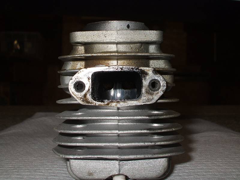

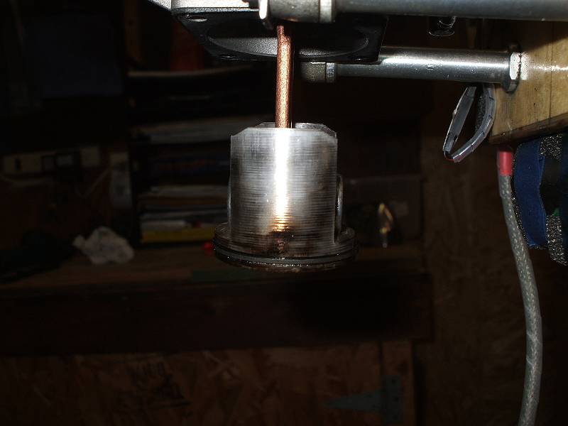

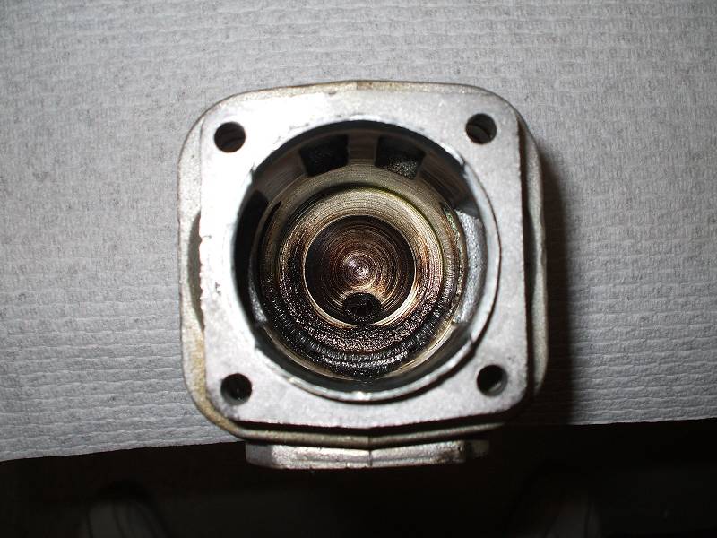

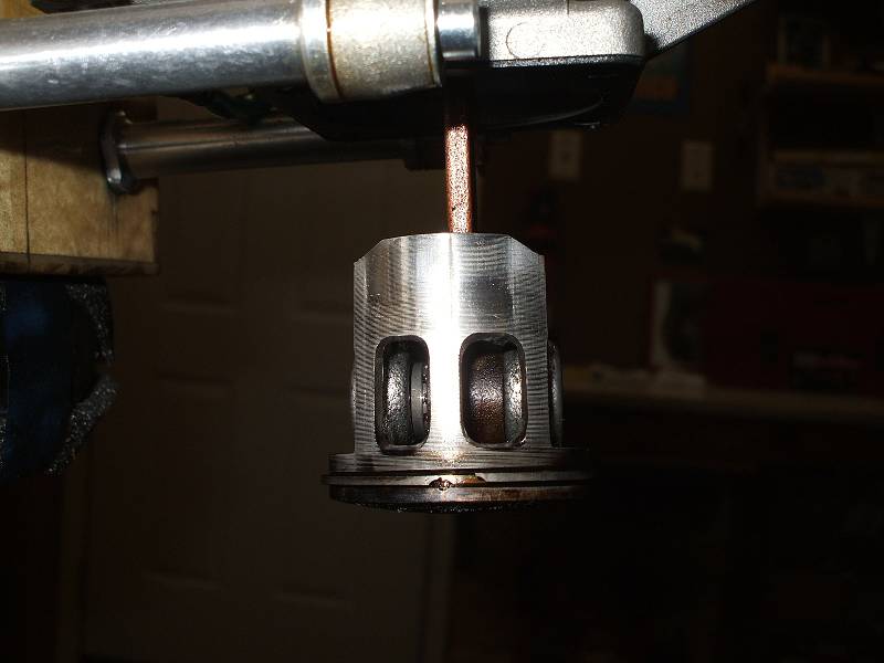

Thanks Gentlemen for your help so far. I came home tonight and decided to pull the cylinder and see what was going on. Before I did I made sure my brain was not playing tricks on me. I put my finger on the prop and turned and turned and it had very little resistance. I also fliped it and it was a little hard to find the compression stroke. What I found was the cylinder had three shinny vertical lines about 3/8 " wide each but not scratched or scored. The piston ring was not stuck I was able to move it easily, not broken, and very little carbon. I will try to post some pics. before I go to bed tonight.

I checked the ring end gap and it's a tight .002" I checked it in several places also.

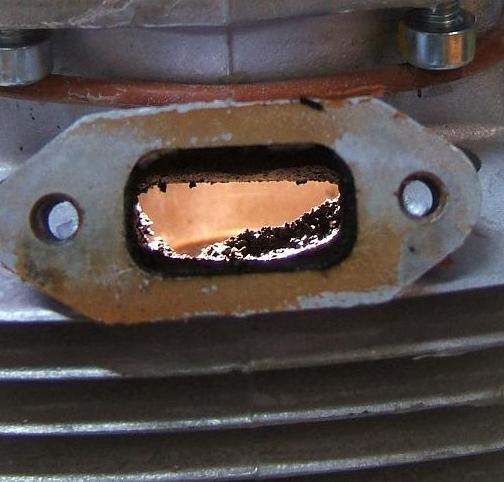

The initiation of a hard carbon crust is evident. The ring groove has started carbon development and a later stuck ring is likely unless it's cleaned up. The carbon trace below the ring on the exhaust side of the piston is caused by a ring not generating the tension it should have, permitting exhaust gas blow by. A condition assisted by too little oil btw. The exhaust port is well on it's way to becoming coked up. It will become worse, eventually blocking a large portion of the port. I have seen this many, many times.
If you would like to save some money and do very little to keep flying the engine, run on down to a local motorcycle or saw and mower shop and pick up some Pennzoil Air Cooled. Echo or Stihl two stroke are another pair of good oils for what you need to accomplish. Mix and run at 32-1 for about 5 gallons or so to let the engine self clean. If you can't find the Pennzoil, Echo, or Stihl, head to Wal Mart and pick up some of their house brand air cooled two stroke oil. Same ratio, 32-1. Both will work and work well. The Pennzoil is better but where you're at it doesn't matter. Both will clean the engine. 32-1 will perpetuate a better ring seal. When you re-assemble coat everything...everything, with the new oil before it goes back together. Straight oil! You'll probably foul the plug after the first start but you want that oil in there. It will take close to an hour for the engine to have completely drawn fresh oil throughout itself in normal running without the pre lube.
A pic below of a port in an engine running too little oil. My thanks to RCU for giving the edit ability back. Without it you would not have the picture.

EXCELLENT follow up!! It's very frustrating to try and help in a situation like this when the original poster offers no pictures for evaluation. I am REALLY happy to see this thread stay on track and see ChristanEagle follow up with pictures and details of how the ring feels. Great job guys, and I stand corrected. We DID see pictures. [sm=thumbs_up.gif]
I don't see excessive piston skirt scuffing and the cylinder looks okay for the most part. I'd probably clean the exhaust port now and then reassemble and run as T.O.M. instructed. It will self clean with a quality oil and a richer mix ratio.

christane can you take a better picture of the inside of the cylinder. If this engine never had compression and still doesn't I bet the cylinder is either damaged, or more than likely from what you have said was not bored and plated correctly. Just what altavillan said. Square peg in a round hole.

I two would like to see the cylinder better, you can't see the condition of the wall at all in the pictures. This has already been mentioned but your description of "three shiny verticle lines about 3/8" wide" could indicate a cylinder that is not exactly round, if so, and this engine had low compresion when new and did not improveafter a couple tanks of fuel, it should have been returned at that time.
