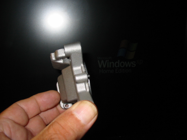

<hr />Antique is right there is no need for the pin. I have no pin now...the pin is in the old rear case I took off. It is a hollow pin about .018 Dia and .550 inches long. I just measured it...got the part in hands reach. The replacement rear case (rear induction) has no pin. I think the pin is in place before they machine the flat portion where the Cly base bolts to case to keep base alighment true. I have seen many locating pins used in Fullscale Continental Air Craft engines &amp; Tank engines. Not a bad Idea....just like Antique says...no big deal...and they are NOT needed. Your choise!
Newbies I am sorry for leading you astray! Capt,n

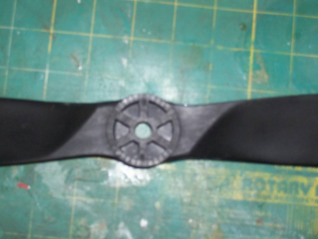

Interesting!!! I went out today with the heavy Master Airscrew prop and the motor was a bear - after running fairly well the last time out??? Switched to the APC 18-8 and same thing. Was very inconsistent. So finally got it running fairly well, but with a higher idle than I'd like and my flap servo began doing the jig. In trying to figure out what made the flap servo mad I noticed that I had a lot of vibration so I changed back to the Xoar 18-8 which I knew was balanced and threw away the spinner and back plate and WOW? No jittery flap servo - great idle, good high end and three very successful flights, one of which garnered applause as I greased in a tail high wheel landing. So after all the trial and error with the heavy plastic prop - I'm staying with the Xoar. I took the old spinner and cut it back to just a pointy thing that sits on the prop hub and threw away the back plate which had been in a few crashes. This is closer to the scale look, although not right on - but closer!! I'm getting happier and happier with the motor - Hallelujah!!

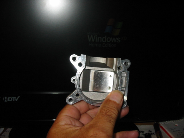

Has anyone used the single bolt conversion assembly for the 30 from Valley View I'm wanting to use my Dynathrust 20x6 and it has the molding pockets in the back side of the prop ordered a new MA classic it also has the holes oin the back side!Would be kinda hard to drill the holes for the four prop bolts and get them lined up correctly. Just wondering if the single bolt adapter might spin on the prop or if it would hold it tight enough!

The single bolt prop adapter that Valley View sells would be plenty. I have that adapter on all three of my DLE 30's, and have never had a problem. You'll love it!
