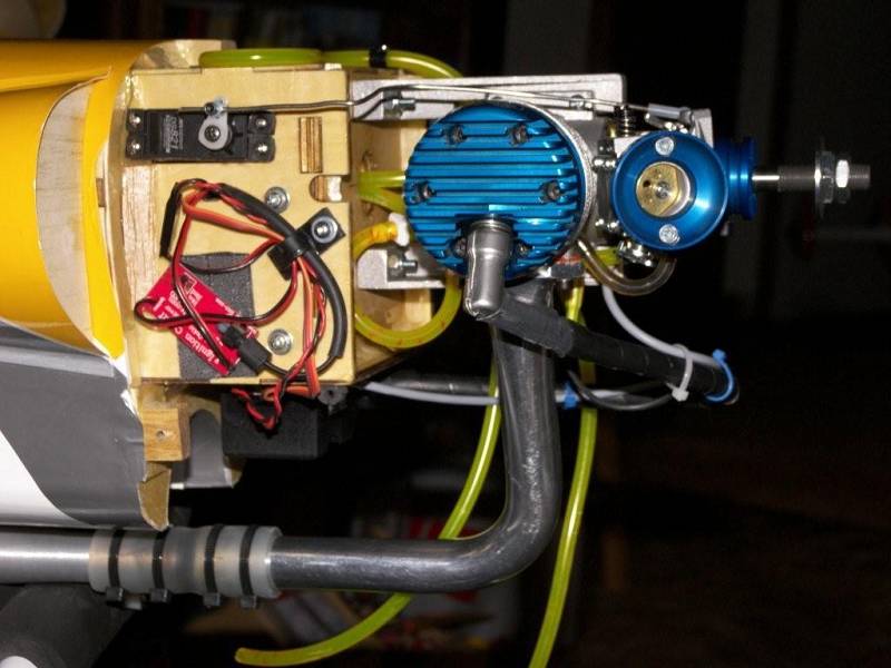

Ok, I'm stumped and need some help.
I've got an Evolution 26 in a H9 Mustang that has over 100 flights on it. Engine has run like a top and has plenty of power for the airplane with an APC 16x8. It's got an Evolution wraparound muffler and I've been using about 5oz of oil per gallon (twentysomething : 1 ratio)
About 2 months ago after over 100 great flights on it with no problems, it flames out on takeoff....but that's not my problem.
I proceed to check the fuel system out completely, and ended up rebuilding the tank to make sure there were no problems. I also cleaned out the carb and double checked the fuel passages and gaskets/diaphram. I had to change the spark plug because the other one broke off. I don't know what the gap is set to. I put it back together, and now it runs like a top again.....but......and here's where I'm stumped....it now seems to get hot after a few minutes in the air and starts surging/quitting. I proceed to rebuild the carb with all new gaskets/diaphrams, and even a new thermal spacer between the carb mount adapter and the carb body. Still the same problem. I can richen it up and make it slobbering rich and fly it around and it still gets hot. I don't think the engine is seizing up, I think the carb is just getting so hot that the fuel/gas is starting to boil. When I land, I can't even touch the carb it is so hot.
What would make this engine start acting like this after so many troublefree flights. Again, it runs perfectly for the first few minutes while it's cool, then the heat starts to soak into the carb and it goes south. Cooling air opening for the engine is right in front of the carb and it blasts right on it before it gets to the cylinder, then the muffler. Could a bearing be going away and causing the excess heat? The engine feels beautiful when you turn it over and will do a nearly impossible tick over idle when cool. Could an improper gap on the sparkplug cause excess heat? Maybe a bad batch of gas?
Anybody have any ideas? I've even replaced the ignition to eliminate that possibility.
Help!
KMac

I don't think the timing is adjustable. The hall effect pickup is mounted to the side of the crankcase and cannot be slid or rotated at all. The ignition unit is just a black box with wires coming out of it with no adjustment either that I am aware. If I'm wrong, I'd certainly like to hear how this can be adjusted.

It is on the end of the module with the little wires. There's a shorting plug. But it is unlikely you have changed it.
If you study how the carb works, you will discover the low speed screw has a big effect on the mid rpms as well as the low speed. You may have the low speed mixture needle in too far?
Oil it has plenty, since the recommended mix is 1:40.
Is the thermal grade of the new spark plug similar to the old plug?
Might it be too hot for that engine?
Besides checking the timing, as recommended by w8ye, I suggest inspecting the exhaust port, and also the muffler, for any obstructing buildup.
For that, you will need to disconnect the muffler.
Excess or less than ideal type of oil can lead to those buildups, which restrain the proper ventilation of the hot exhaust gases.

I have both MVVS and the Evolution 26cc engines. On break-in I used Mobil 1 racing 2T fully synthetic oil at 30:1 for the first two gallons and 40:1 after break-in. MVVS and Evolution support says you must use fully synthetic. I have a tuned pipe on the Evolution and a Pitts on the MVVS. The timing was set by a shorting plug that plugs into the ignition for each setup. I have the Evolution in a H9 Sundowner and the temp is about 180F on the ground at full rpm. The MVVS is not in a plane yet, but on the test bench, it is almost exactly the same as the Evolution. I would run it at max rpm and check the temp, if it is in the high 200 or more, I would send it to Horizon for them to check. I sent my Evolution 26 in because it leaked out the front bearing, they repaired it and even paid the shipping both ways. It does not leak now.
The carb getting hot, with all else the same as before indicates crankshaft rubbing in the front bushing. This can be due to lack of cooling, or crankshaft/bearing combo out of whack. Did you get a prop strike? I suspect either a bent shaft or worn front bearing.
BTW proper plug gap is 0.020 - 0.024 " Too small a gap may also cause hot running.
