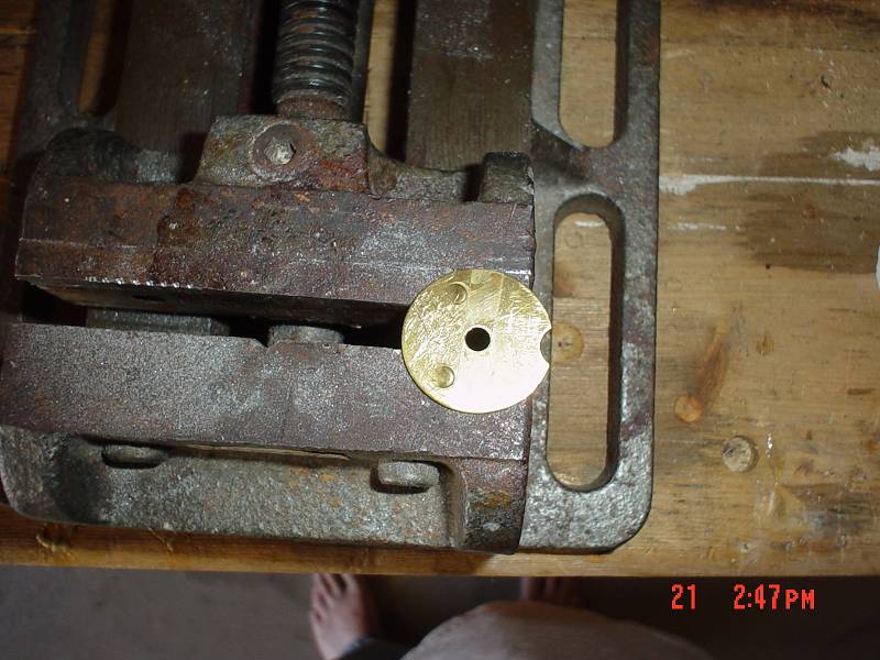

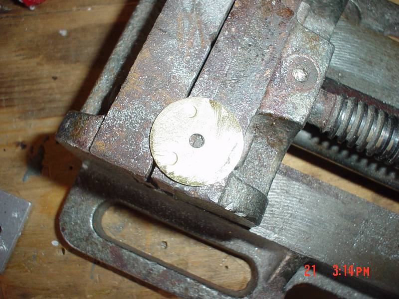

Rich,
Here is the results of your suggestions. I haven't tried it yet, but will tomorrow or thursday. I will let you know how it works. Thanks again, Ken

Old 07-21-2009 | 07:01 PM
Joined: Jul 2009
Posts: 4
From: monrovia, CA
Default RE: 3w75
Please be sure you restake the screw you removed , engines do not like those little screws inside. Don't ask me how I know this. lol

Default RE: 3w75
That would not be a good thing. I did use lock tite to make sure it doesn't come off. I know this will help with the starting.

ORIGINAL: Meekskin
Rich,
Nice job soldiering.

Default RE: 3w75
Thanks,,,,Like you said, it took about 15 minutes to do. Hardest part was the filing to get the solder smooth so it would fit back into the slot.

Default RE: 3w75
Started my 3w75 this morning for the first time after the carb mod. I turned the prop 7 times to prime the engine, turned on the ing. and tried to start. The engine was flooded, so I opened the choke and the engine started on about the 5 flip. It sure works a lot better than before the carb mod. Now all I need to do is determine how many turns it takes to prime the engine and then turn on the ing. to start. I am guessing about 3 flips but will pull the cowl and watch the fuel line to the carb. Thanks again Rich for the carb mod.
