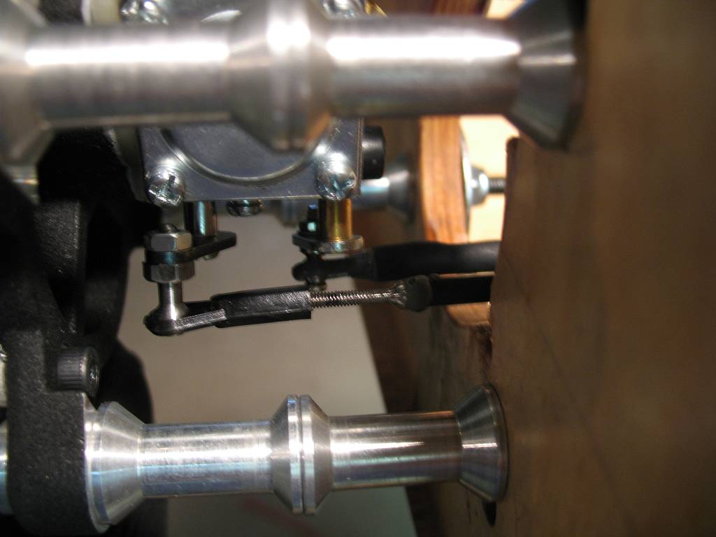

Figured out the choke connection on Friday. Used one of those short brass servo "bushings", it was close enough to the ID of the choke arm. Picked up a 2-56/2-56 DuBro ball link, the 2-56 machine screw is a perfect fit in the bushing. A bit of locktite on the nut and cranked it down - not going anywhere. Did have to sand the ball link shorter to keep it from hitting the firewall. I'll run Goldenrod back to a 81MG (probably) to actuate the choke - still looking for a way to do that manually if possible - may try a bellcrank and turn it 90 degrees out.

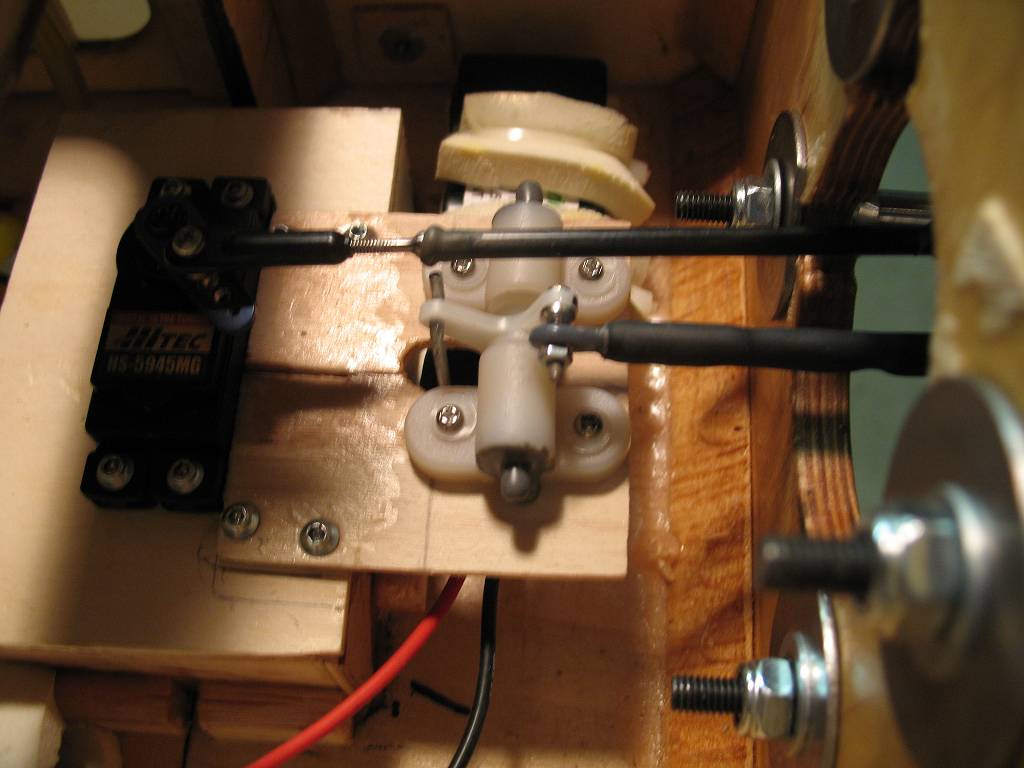

I did this on two 50NG's. It's not that hard. I think I bought a small nylon nose gear assembly. I mounted the nylon "pillow blocks" on a little 2x3" thin ply plate with 2-56 hardware. I used a piece of brass tubing as an axle between the two nylon "pillow blocks" to hold the bell crank. The axle went left to right in the motor box. I used a 2-56 ended carbon fiber pushrod that went between the top of the bell crank and the choke arm on the carb. I used a 2-56 ended (one side only) 2-56 threaded rod on the bottom of the bell crank and let it hang straight down. I just push and pulled this by hand. I used 4 servo screws to fasten the ply plate assembly where I needed it. I can post pic's to explain it easier.

PS: I forgot that I had to drill a hole in the ply plate for the rod to go down through. The plate mounts on a horizontal plane....stood off the bottom of the motor box for example.

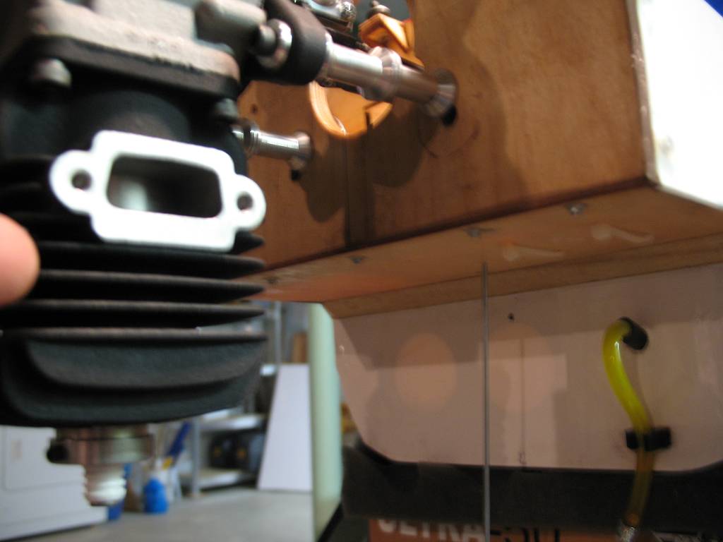

Looking at what you wrote, and some of the pictures I've slurped off the GP Ultimate 160 build thread, here's my plan:
Mount a piece of 1/16" ply "fore to aft" between the firewall and the fuselage former that will allow me to mount the bellcrank vertical. The forward part of the 90 degree bellcrank will be vertical, I'll run typical dubro 2/56 ball links and 4-40 rod from the choke to the bellcrank (2-56 ball, 4-40 bolt). The other part of the 90 degree bellcrank goes aft, I'll put another ball link on it and "drop" a 4-40 rod straight down to between the landing gear mounts (adjacent to my fuel tank vent. This should allow me to reach under the plane and push up or pull down to work the choke.

Here they are. Let me know if you need anything else.

Between you and Keary (from the Ultimate thread), I solved it. Ran a support front to back in the engine box, took a 90 degree bellcrank and transferred the motion down.
Old 08-07-2009 | 11:28 AM
