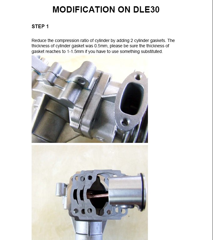

It's from DLE website: http://en.dlepower.net/news_view.asp?id=6
DOWNLOAD: http://en.dlepower.net/uploadfile/20091109194606158.pdf

The DLE will send to all your constumer around the world the extra gasket?.

Are you going to send extra cylinder base gaskets to dealers? Also will dealers be able to send the cutomer a new Base gasket? Last will the engine loose power after adding base Gaskets? thanks very much. Capt,n

Hi guys, i just saw this news and paste it here. i'm not the manufacturer. I think they'll send gaskets to their dealers and forward to people. I've done this on my DLE30, the idle is around 1500-1700RPM now but the maximum RPM is 100RPM lost with 18x8 JXF prop.

It might be an easy fix, but I doubt it is the best fix other wise.

DLE screwed the pooch. Wrong actions for the malady.

Took the cheap route.......not a proper fix.

It seems like the proper fix is for no #1 increase the combustion chamber to lower compression. It seems like adding base gaskets to bottom of cylinder is going to change port timing a bit? #2 have the carb right to Begin with...at least on the ones being produced now. Hope to get more new form DLE MFG on that. Best Regards Capt,n

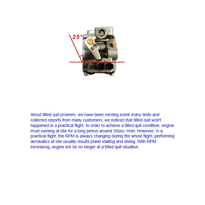

It is actually very easy, you will use a thumb drill. It looks like a writing pen that is hollow and holds many small drill bits. It does not take much force or pressure to drill out these small holes in the carb. You will not use anything but your fingers, no drill needed, I've done re-jetting this way before on different parts of many carbs.
This is more like a band aid than a fix if at all anyting, still not quite sure why there is a need to enlarge the idle circuit, etc., but I haven't really thought about it yet either.

if you have a fuel puddling issue you have an excess of fuel. Or perhaps I'm missing something there. Enlarging the low end circuit increases the quantity of fuel that can be moved. Now the puddling occurs at low rpm, so logic dictates you might want a little less fuel, not more at low rpm. In any event, you don't want fuel to puddle in various locations where it can accumulate and suddenly dump into the case, which is what a few people are experiencing. The cause of that is no longer in question, just the decisions about the final cure.
So no, I cannot see wher adding a couple of gaskets, altering the squish band, lowering compression, and altering port timing will be of much help. Nor would opening up the idle circuit to draw more fuel at low rpm.
So I'll stand with my comment about screwing the pooch unless someone has the ability to convince me otherwise with relevant data.

This mod does NOT address the tilting issue, read the last page. A few people have had dificulty getting an acceptable idle that is low and stable enough to fly or land their plane. That is what this mod addresses, it looks like they are discounting the tilting issue on the last page.

Yah right,The engine is already getting too much fuel so you drill out the idle jet and lower compression.
I flew three DL 30 over the week end.Two were mounted upright and one inverted.I just do not find any problem with these engines.They idle fine and we have tilted them every way you can and they just kept right on running.Idle at around 1600to 1800. 1500 0n idle down for landing .I flew many flights up and down and taxied back every time but one.I am not a super engine tuner in fact kinda sloppy at it.TKG does a better job then myself.O-well I am to old to worry about it.

I don't have a dog in this fight but from the pictures it appears to me that you are drilling out an idle air bleed and not a jet. All air bleeds are on the outside of the butterfly. Without having a carb to inspect this is pure speculation on my part. If I'm correct drilling out the idle air bleed will lean the mixture at idle and help prevent the puddling.

With all due respect, you are incorrect, that is the idle FUEL orifice not and air bleed.

Yep, thats one of those little hole hoochiecoo thing-a-ma-bobs that lets fuel out. If you need the technical definition

Jody, so this hole is on the engine side of the butterfly and not on the intake side?
