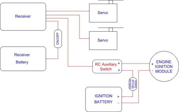

I don't build rockets, so bare with me here. If my set up were like the one in post #14, would I have to in effect peel the wires apart on my switch harness and splice the switch in that way?
For some reason I can't make the connection. Thanks_bob

Hi Bob,
If your existing setup is a manual kill switch only, and you wanted to add a remote kill switch (RC-100 or other), then yes, you would need to cut into the wiring harness on either the red or black wire (not both). The RC switch wires would then splice into the area where the wire was cut. Hope this clears things up but if not respond and I will try and elaborate further.
Regards,
Kai
Regards,
Kai

That should do it. If I used your diagram as a guide, I would want to cut the "+" wire between the existing switch and the ignition plug.
Also, it doesn't matter which wire I use coming out of tht RC-100 on the switch end or the module end. In other words there is no polarity. Thanks for the fast reply_bob

Bob,
You are correct on both counts.
By the way, an added bonus to hooking up the RC-100 in the way you are doing it (with an electronic ignition) is, that if the receiver power is not on, the RC-100 is open and will not allow the engine to start.
Kai

The RC-100 electronic switch looks simple, but if the switching and RX halves are not isolated, won't there be RFI issues? How many of you are using it for ignition? The company is advertising it for ignition, but actually shows photos and wiring schematic for a smoke system on/off.
There appears to be ignition power (and RFI) flowing through one side of the RC-100 switch via the spliced-in connection The other end of the very small RC-100 switch plugs directly to your receiver.
Sounds like this could lead to an RFI problem.
1. totally optical system, or
2. a servo pushing on a LONG nyrod to a mechanical switch
either #1 or #2 sounds like a better way to guard against stray RFI with an engine kill switch.
