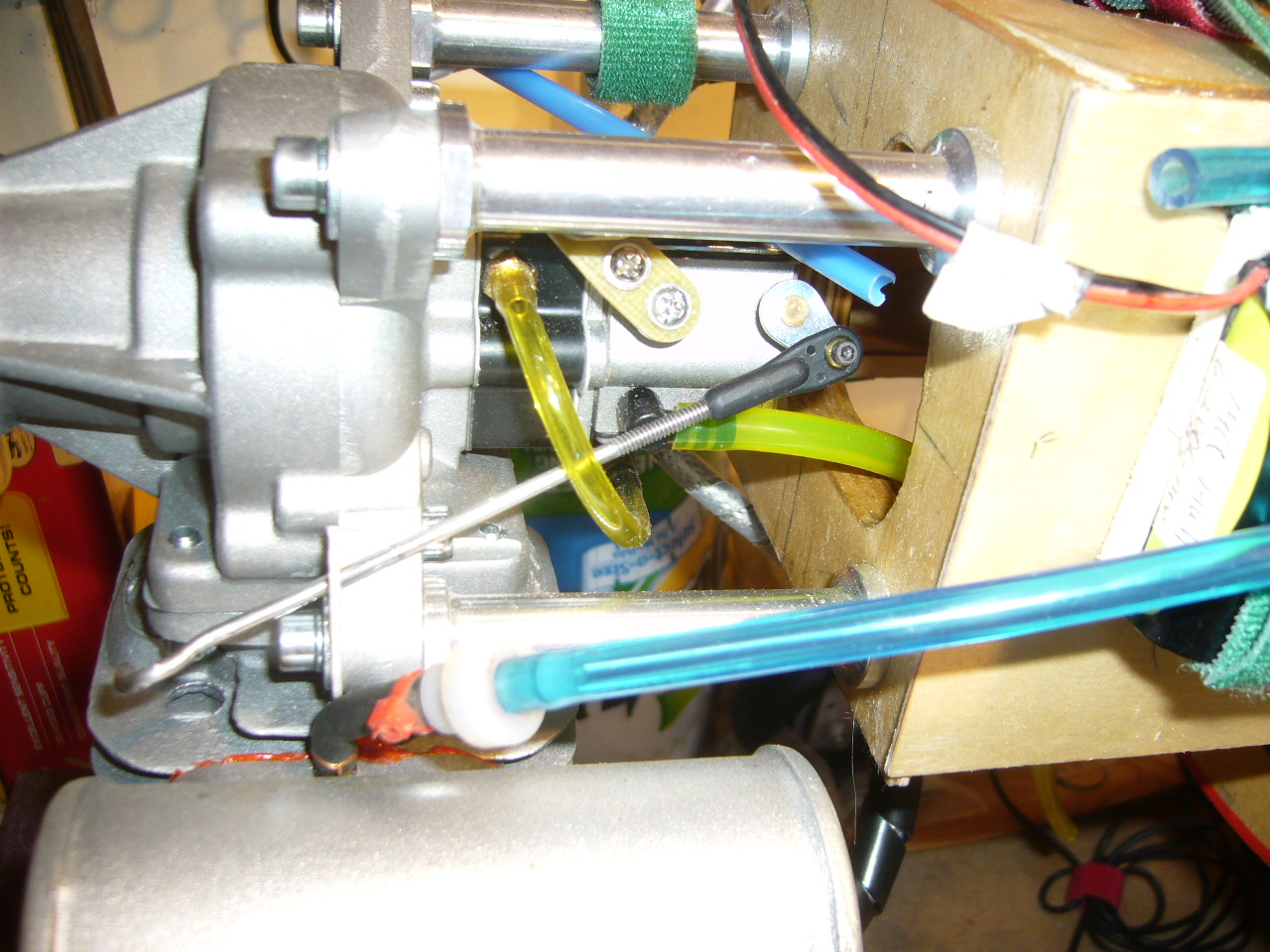

I am currently setting up an Aeroworks 50cc Extra 260. I am using a DLE55 in this plane. My question is how to setup the choke for either manual or servo operation. The choke lever is almost directly inline on the same side of the engine with the throttle lever.
Looking for a goodway to easily operate the choke. If you have pictures of your choke setup on a DLE 55, please help me out. (Pictures if possible)

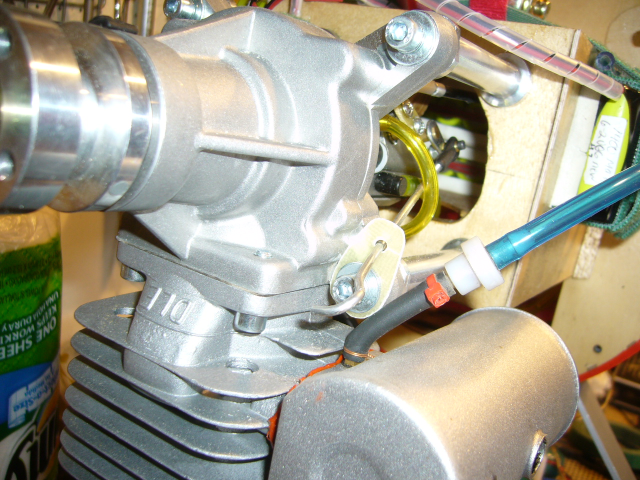

Here is what I did and it works great. Just remember which direction is "choke on" before you put the cowl on. I have screwed that up at the field
picture is from the DLUSA website. Credit where credit due.

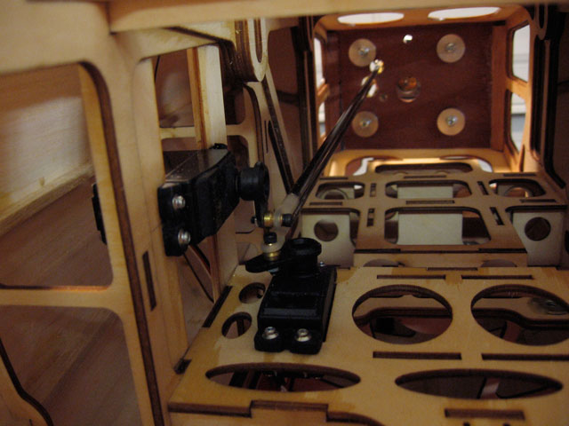

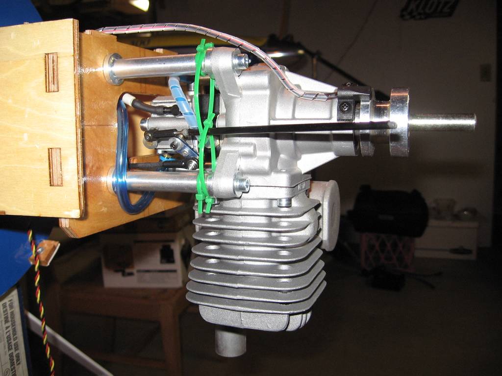

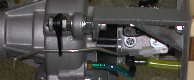

I did mine basically the same way. You can angle the "guide" to make it accessible from the cowl opening, or run it back with a bellcrank to the side of the fuse. Both of my dle's are "push on" "pull off".
sam

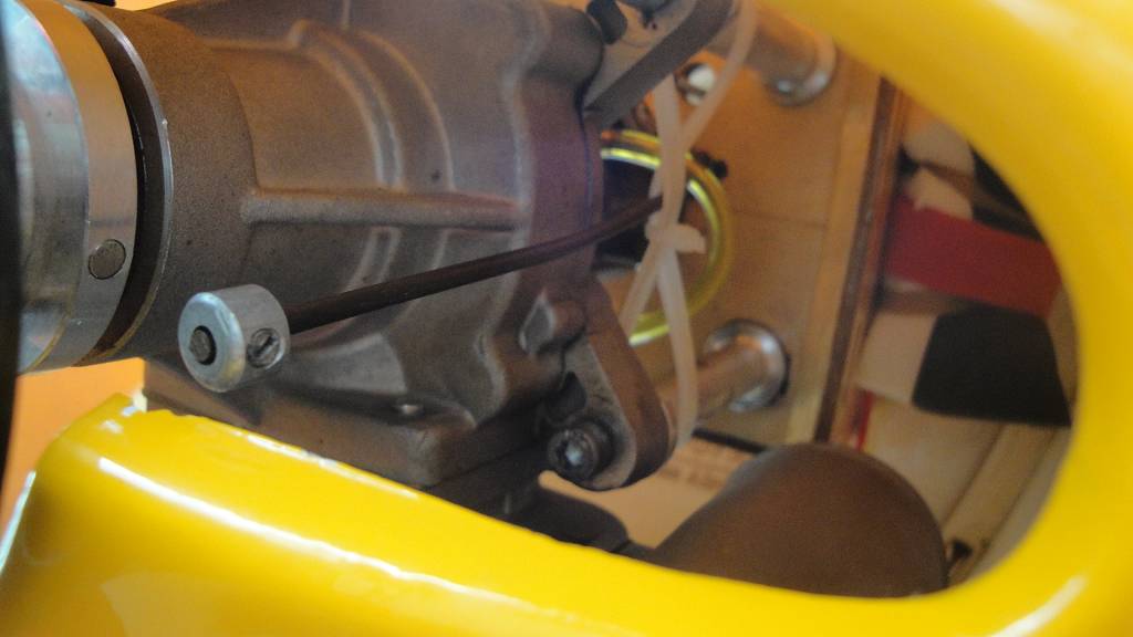

My stadard setup: CF rod with titanium 2-56 end and a 2-56 ball end. Zip ties hold it in place.

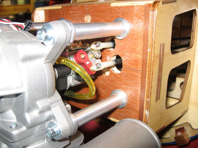

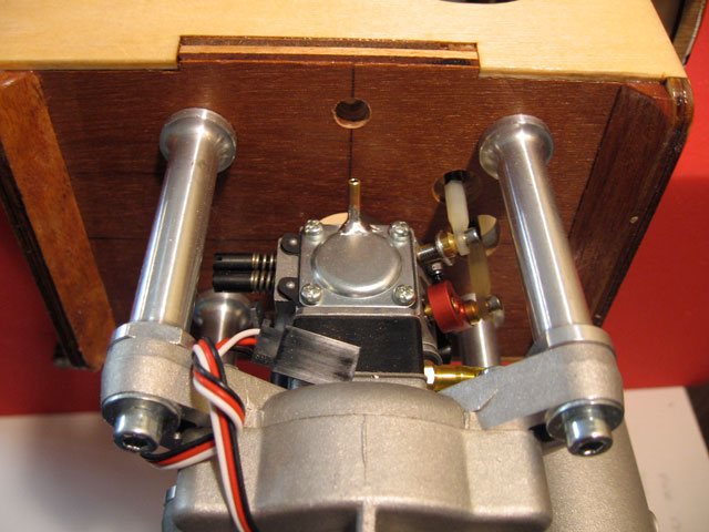

I wanna play. Here's mine:
Maybe I can post a PDF of the templates if anybody inquires.

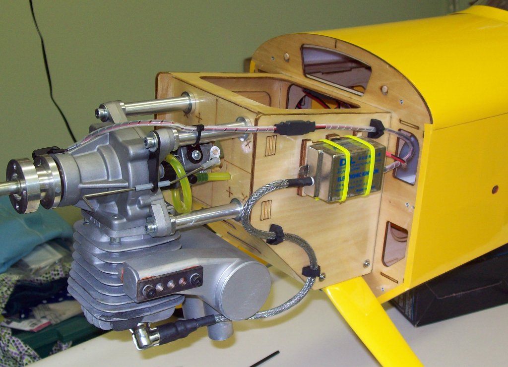

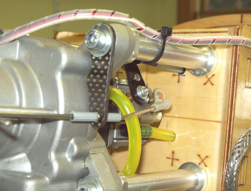

I do like simplicity in aircraft set-ups, but prefer to have servo actuated chokes. The advantages outweigh the disadvantages, IMHO. No matter how small the gasser, having to get your hands in the path of a prop, even when stationary, is dumb. I have witnessed 2 incidents where when the ignition was turned on the engine kicked over.
Another advantage is that I can crack the carb open and control the opening while warming up an engine. I also have the choke included in my failsafe and engine kill setups.
To each their own as it is your aircraft and you get to choose how you set it up.
Below some pics on how I did a DLE-55 in a Pitts M-12.
