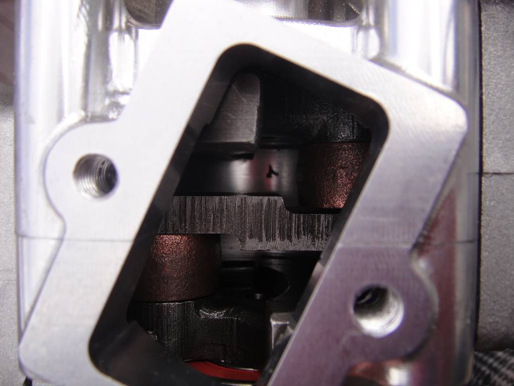

The engine I received MIGHT be a total piece of DUNG. Not just missing the carb but the reed block too.
I was thinking the piston thing MIGHT be to keep the cylinder temps the same but the notchy binding at BDC? Shouldn't a new engine turn over smoothly? All other brands I have ever owned (BME50, BME110, DA100, even DL50 and DLE30) rotated smoothly. I had noticed the two 35's they sent had the piston movement off a little but this engine is grossly off.
I think it is time for Tomy to respond to this thread and Jack to send me another complete engine Express mail. If they don't have a "s" then send me a regular 70 and I'll change the cylinders myself. This is the second time they sent me junk and or an engine full of crap/missing parts. I wasn't in a hurry to fly the 35 so I didn't care however I've been waiting to replace my DL50 with this mt70s and now that I have it I still can't fly it.
Unit, Have you seen the offset link that connects the front and rear crank halves or the tiny bearing that holds the rear crank end? Also no oil holes, slots or notches in the con rod ends for lubrication and the rod side clearance is pretty tight so there's not a lot of oil getting in there.
If they can't get these issues resolved I will have to conclude this manufacturer, TOMY, knowingly sells junk and doesn't care.There is no quality control, manufacturing tolerances or pride in workmanship.

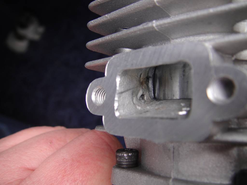

That exhaust port looks about the same as one on my MT35 that I had to return. My first MT35 seized just by turning it over by hand so I returned it and my second MT35 had many problems. ie. missing a bolt that holds the cylinder to the case, bad looking casting of the cylinder, loose fitting prop drive, locking choke that does not work for RC, ect. I ended up returning the second engine as well, so between two engines I did not even manage to get a prop mounted. I did get my money back but I was still out $40 in shipping. I would recomend staying away from MT until the QC improves dramaticly.

Did your engine rotate smoothly out of the box? Mine is notchy and binding at BDC. One piston is 1mm shorter than the other from the ring to the top of the piston which WILL cause imbalance in both compression and weight plus one cylinder will run hotter. There is less than 1mm of clearance on the con rods and no way oil is going to get into the needle bearings. If MT engines adds oil holes, slits or notches to new production what about the engine I bought? Am I sh!+ out of luck?
The engine bolt pattern matches the DA 50 not the DLE55. The 70s is about 35mm longer than the DL50.
If Tomy desires long term success selling engines he must tighten manufacturing tolerances and add quality control. I didn't buy this engine on price, I bought it because it would fit my cowl and it's supposed to make about the power maybe more than a DA50. I would gladly pay 30% or even 50% more for an engine that has been properly engineered with high quality materials, beta tested, has been test run at the factory, and will be upgraded free of charge like a DA.
IMO the little 1/4-32 plugs are too expensive and fragile for a serious IMAC competitor to bother with and they will not purchase this engine because of this. If Tomy wants that market he will need to copy the EVO 26GX style combustion chamber and add the heavily slanted CM6 plugs or do something similar to incorporate the cm6 plug.
I have nothing against Tomy, Jack or MT Engines. On the contrary, I wish them well. Good intentions and well wishes will not build quality engines. I have been doing a bunch reading about MT Engines. Quality control has never been a strong suit of this company.
The "s" version cylinders are a new production run yet the cylinder in the photo clearly has a poorly cast exhaust port which is one of the items I pointed out with the 35. The DLE castings are far superior and the cost is close enough MT should be rejecting such parts.

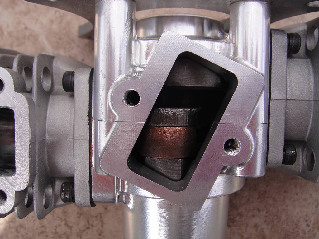

The engine looked clean inside but I removed the cylinders and flushed the crankcase out. Got a fair amount of grit and aluminum flakes. While the cylinders were off I cleaned up the exhaust ports a little and then flushed them too. I reinstalled the cylinders and found the cylinder bolts were too long and bottoming out. I cut them down and chamfered the ends. Tomy said he assembled it at Toledo from a mt70 case and "s" cylinders but I still don't understand why the tappings were not deep enough. The screws that came with the 70 are the same length as used on the MT35.
Anyway, the notchy feel happens when both cylinders are torqued down evenly. If I loosen the carb side bolts on the rear cylinder the notchy binding goes away. Any suggestions?
Now that I have the carb/reed block I can make a 2 into 1 header and see how it will work with a KS 86 can. It might be better with a JMB can.

Regarding the binding,
If I leave the forward exhaust side cylinder screw loose it doesn't bind as bad. It feels like the needle bearings are binding do to a misalignment of the cylinder/crankcase.
