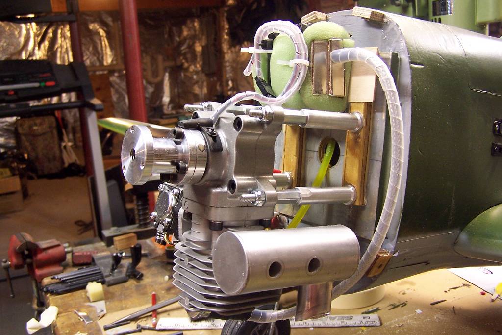

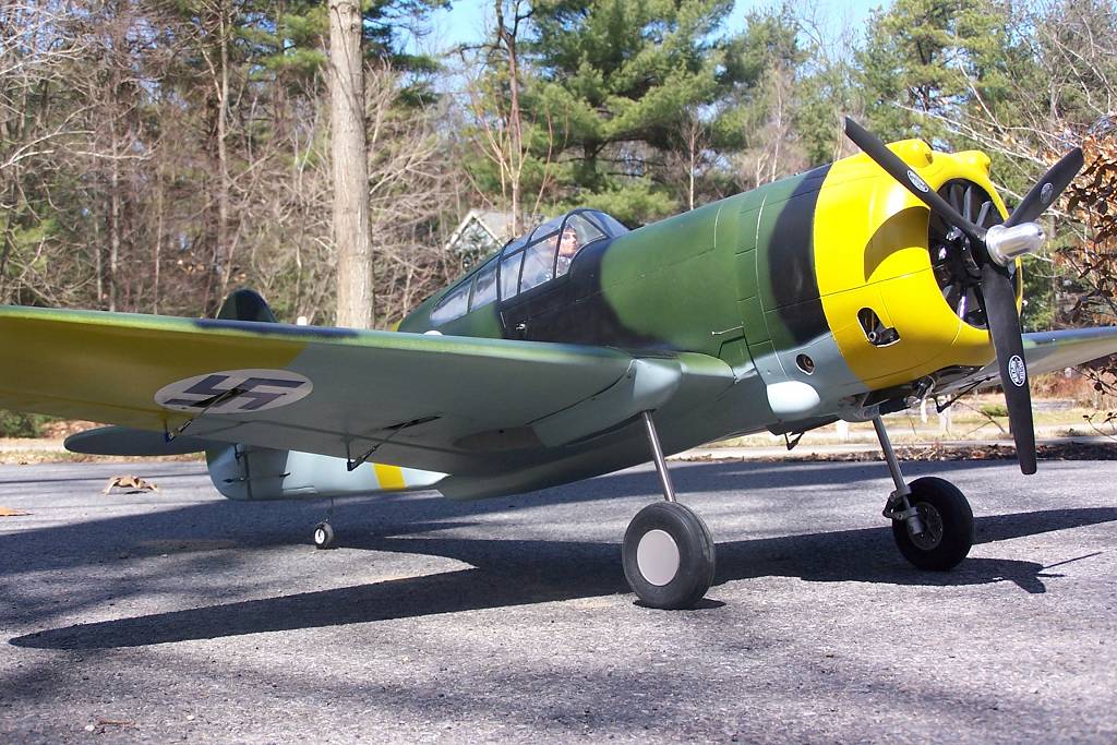

Default RE: RCGF 20cc
I have the RCGF 20cc on a P-36 scale airplane which weights 11.2 lbs. It turns a 15-7 three bladed prop 8,200 rpm and the plane has way more verticle than is needed.
