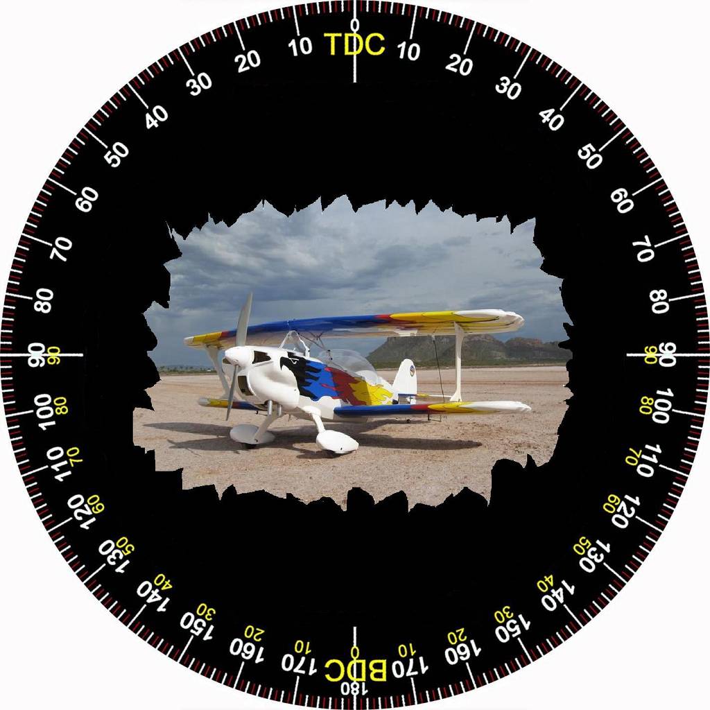

Need some advice. I have a new Turnigy/FTL 52cc engine. I have yet to run it but would like to know if there is available commercialy, a timing checker? I am used to a timing light etc for car engines but would like to know if there is a specialty timer on the market for RC gas engines.
If not, could some of you tell me how you are timing your engines and to what degree before top dead center.

I have one too, just haven't run it yet. I wrote this for another guy, but it will work for you to.
Get Pennzoil, run it at 32:1 all the time.
Do check the timing, here's my way:
The easy no math timing.
Cut a strip of paper 1/4" x 5".
Rap the paper around the prop drive, back by the crankcase where the magnet is. Overlap the paper then cut with a #11 blade cut though both layers of the paper.
Now you have a piece of paper the exact circumference of the prop drive.
Cut it in half, take one of the halves and cut that in half again, take that and cut it in half also. Now cut it so it's in 1/3 and 2/3 pieces.
The 2/3 piece is how much before TDC the engine should fire, (30*).
Now find TDC by removing the spark plug, then sticking something in the hole, a pencil works fine. Move the crankshaft until the piston. is at the top of the cylinder, you'll find that about 5* either side of the TDC it doesn't feel like the piston is moving. Wiggle the crank back and forth until you can find the center of this piston not moving zone, that's TDC.
Now with a marker make a line across the edge of the prop drive onto the crankcase, it doesn't matter where, just that it's easy to see.
Now turn the prop drive clockwise a distance equal to the 2/3 piece of paper.
Plug the ignition into a 4.8v battery, and turn it on.
Now with the two screws loosened move the sensor off the magnet until you hear the ignition pop.
Tighten the screws for the sensor down, then confirm that the timing is still set that 2/3 piece of paper before the TDC mark.
You may have to lengthen one of the grooves in the sensor mount to get the timing correct.

you can't cut something in half and get 1/3... if you want to use the paper strip method, measure the length of the paper divide it by 360 and multiply by 30, or just print yourself off a degree wheel and have a piece ofcoat hanger as a indicator...
Easiest method..
Take the plug wire off so you can hear the spark.
turn the crank (CCW) slowly..when you hear the spark make a pencil line across the hub and crankcase..
Measure hub diameter, multiply by .244 for 28 degreess...put piston on TDC..Marks should be that distance apart...

A easy way to verify the angle:
"By light of spark to verify the angle"
First,screw out the plug,make it eay to rotate the shaft,and drag the HT wire near the shaft,then turn off the lamp darken the entironment, rotate the shaft,make the HT spark onto the shaft.
you will see the firing angle pretty clearly.

Quick and dirty set it so the spark is 3/8" BTDC you'll be very close on any engine I measured. I just do it by eye, the engines with 6 bolts shows you what 60* is, if you can't hit 30* within 1~2* by eye put the beer bottle down.
Thanks guys. I really appreciate it. Cant wait to get back home and fire this engine up. By the way do any of you have the Turnigy 52cc? If so how does she run and what prop are you running?

I like using a huge printed protractor so I can easily see the degrees and attach a pointer to the cylinder with a paper or spring clip. Also using a cheap-o dial indicator and magnetic base to find TDC is so easy. Set up the indicator, rotate the crank until the piston is at tdc and zero the indicator. Rotate the crank both ways until the indicator moves .001" and mark the protractor at both locations and divide in half to find exact tdc. measure over 28 degrees CCW from that point this is where you want the spark to fire or the rcexl to stop glowing and sounding. Adjust the sensor to make it so and tighten the screws. No guessing, no that should be close, it will be exact.
You can also use the indicator to check for crankshaft runout. You might be suprised to find out what's really making your plane shake so much.
CH ignitions came with good instructions.
Here's one I made how I like them to be graduated. If you can't enlarge and print this one, let me know and I will e-mail you one. And by the way, you can't really find true TDC with a dial indicator without measuring to a certain value on each side of TDC and then splitting the difference, as mentioned above. The positive stop method is easier, and faster...

Zippy....thanks for the link to see how it's done...very helpful
av8tor77...thanks for the wheel....got it printed.
Now I'm ready to try it out and see how close/off my engines are.
