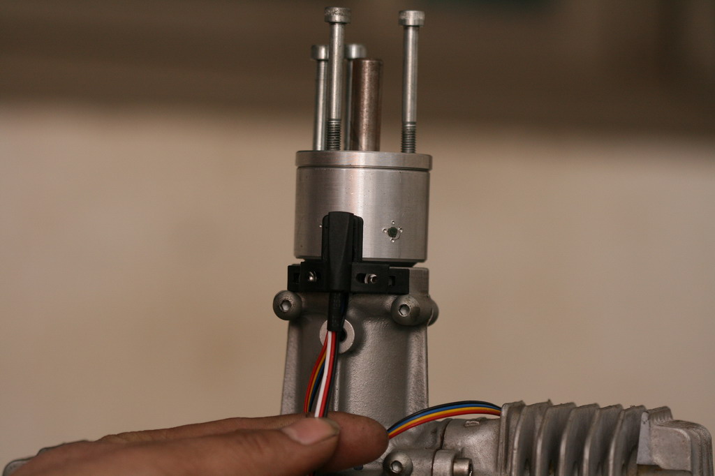

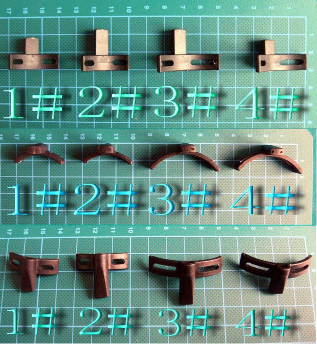

If you have the two magnet 3W it is a plug and play conversion, Just set your polarity to the gray magnet and time it. Only tool needed is a screw driver.
If you need help timing your engine, go to the link below and click on the link for timing you engine
http://www.rcextremepower.net/ignitions.html
Some people have said that the 3w has more power with the timing set at about 32 deg before top dead center.
If you have the older style you will have to drill and retap threads to relocate the sensor, Secound picture
You need to use sensor braket number 3 in the picture below
