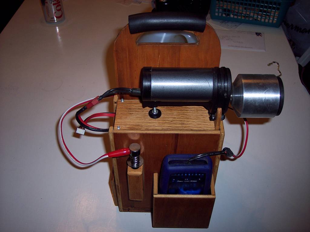

This Magnum starter does the trick for my OS160 and OS140 when they get cranky. I like the compactness. I run a 4C Rhino 2350 pack and am able to start my stuff and even lend it out to others. Couldn't resist showing my starter caddy. Made it from Dad's old shop project. Thanks Dad!

[img][/img]

You need a starter with gear reduction system (like what RC11 shows in this thread) to start big engines like yours.
You can check out this URL http://bpassociates.homestead.com/bp.html. I also believe MAXX products has one. The KAVAN starter probably has enough torque for the job.
