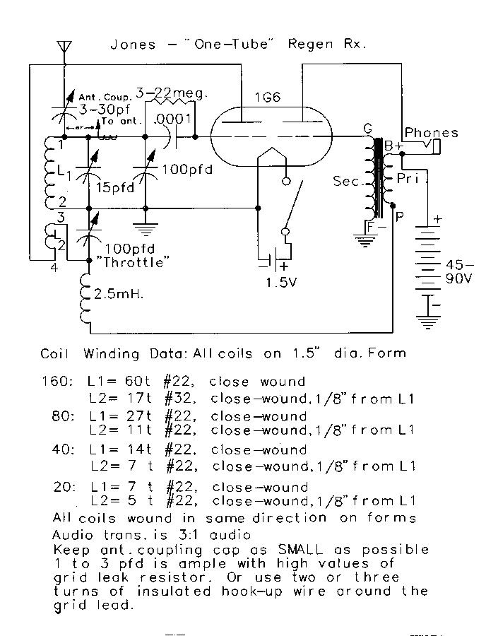

Old 05-11-2010 | 10:18 AM
  #112
JNorton's Avatar
Posts: 4,338
From: Coopersville, MI
Default RE: Ignition loads current verses input voltage
It would be a heck of a lot more fun. Built my first transistor radio using a CK722 as a class A amplfier. It used a 1N34 germanium diode for signal detection.
John
