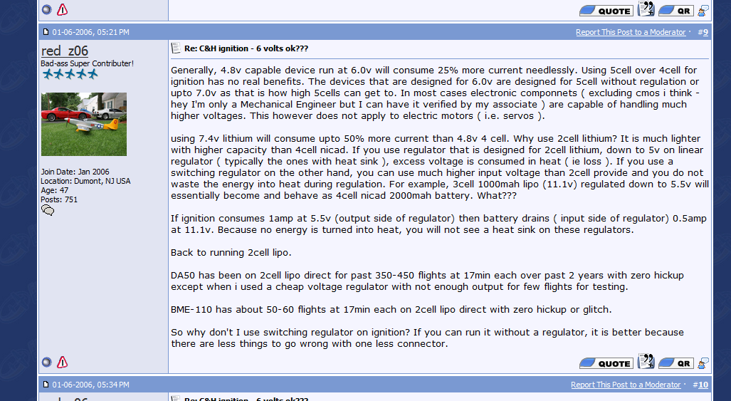

Ignition loads current verses input voltage.
It was stated in the Evolution 58cc dying thread by a member that higher battery voltage results in lower current draw. Quote “Check out ohms law!!! The higher the voltage the lower the current draw, FACT!!! “
This is backwards. A higher source voltage with a constant load always means a higher current draw.
First you need to know what the load resistance is. To do that ohms law says R=E/I . Lets use 4.8 volts for the voltage. For the current I’ll use what bcchi stated (since he builds what most consider the finest ignition systems on the market).
“The RCEXL for example a clone of mine. On average will draw 400MA at 8000 RPM,4.8 volts ,500 MA at 8000RPM 6 volts,600MA 8000RPM.7.4 volts.Go figure.I just went and checked 10 new CHRCEXL ignitions..This was average on all of them,not all exactly the same but close.”
So lets use 500 mA or .5 amps. The load resistance is therefore 4.8/.5 or 9.6 ohms.
If we use a 6 volt battery pack the current draw is I=E/R or 6/9.6= .625 or 625 mA current draw.
Higher voltage results in higher current. Sorry guys but this was really bugging me.

Shezzee Ed thanks for muddying the waters! You are talking about transformers or the transmission line itself. Wattage with the same load will also increase when you raise the voltage for a fixed load. Lets take the same example.
So lets use 500 mA or .5 amps. The load resistance is therefore 4.8/.5 or 9.6 ohms. P=IXE .5 A X 4.8 volts = 2.4 watts
If we use a 6 volt battery pack the current draw is I=E/R or 6/9.6= .625 or 625 mA current draw. .625 A X 6 volts = 3 watts
IF THE LOAD REMAINS THE SAME - AND YOU INCREASE THE VOLTAGE THE CURRENT WILL ALSO INCREASE. PERIOD.
Kurt it does not prove your point. Look at the math. Please look at the math.

Even in a variable load for any giving point in that load if you increase the voltage for that given point the current will rise to. A variable motor loads gets tricky determining battery life and ESC capacity.
I just want to nail this concept down - if you increase voltage to a load the current will increase. It doesn't matter if you use power or current as everything is related in the formulas given. They are not separate stand alone entities. Change one value the other will change. You cannot have current flow without having power being dissapated through a resistance. Power is related to the voltage times current drawn. In addition every component also has capacity and inductive values present.
Look at the chart.
