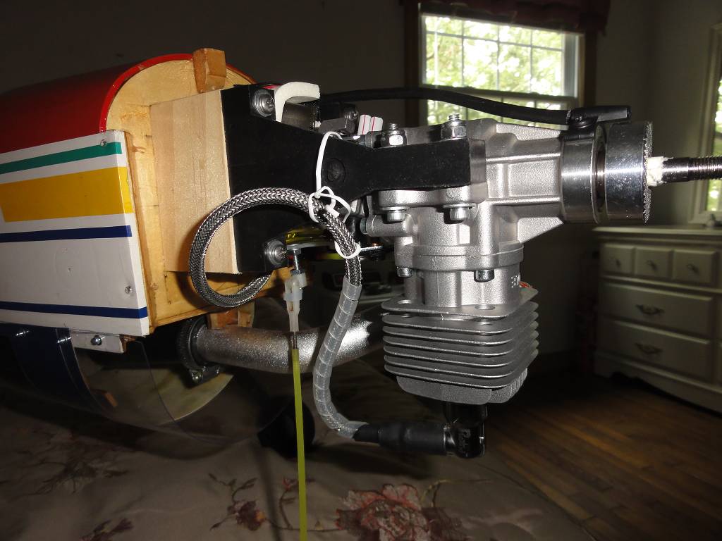

Here are a couple of shots of my engine mounted in my Arrestti. Hope they are viewable. Bob
ID:	1644691   Click image for larger version
ID:	1644692   Click image for larger version
