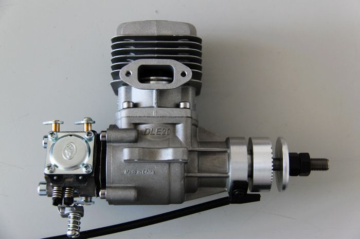

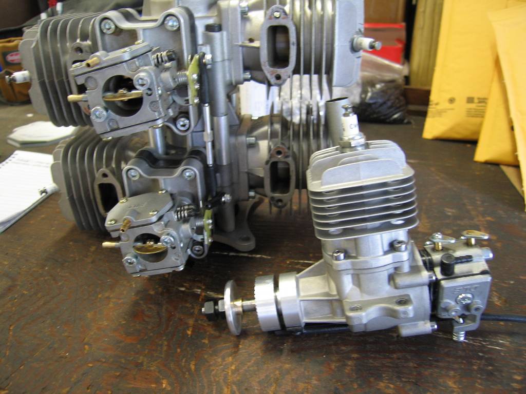

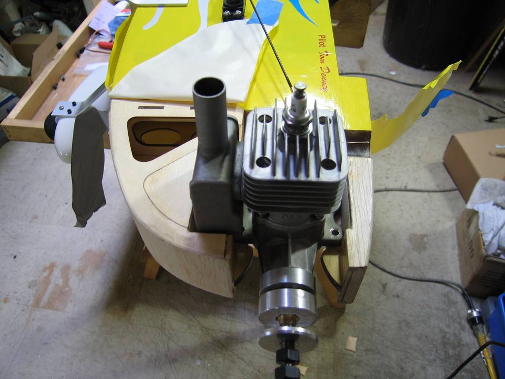

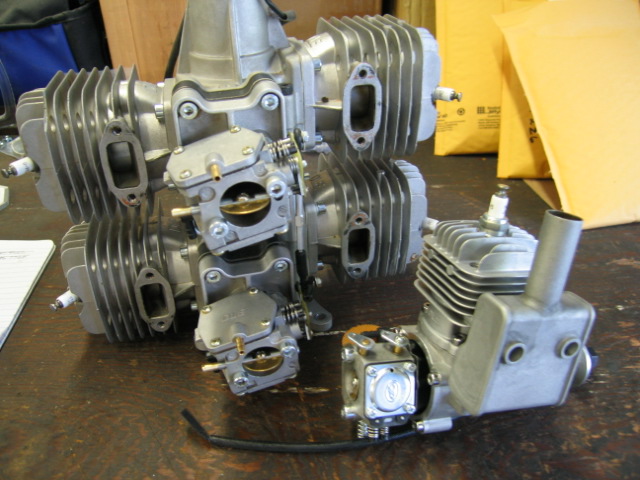

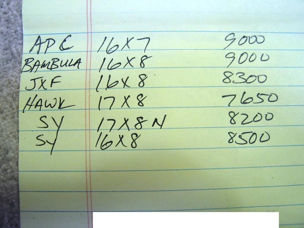

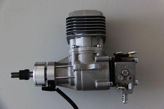

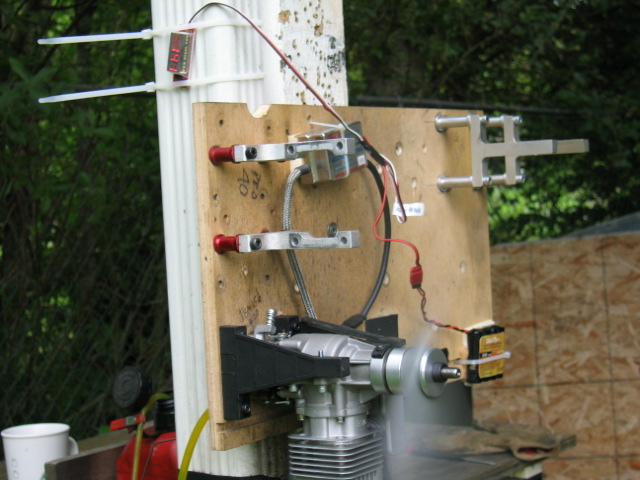

OK, went out and flew the DLE20 this evening, it's an excellent runner especially for it's size. The SD Models 60" profile it was in weighed 7 lbs. 15 ounces dry. The 6 ounce fuel tank I used will run for 10 minute flight and still be 1/3 full. When was the last time you could fly all weekend on 1/2 gallon of fuel? Took some thrust numbers on the props I posted RPMs on the other day. I'm sure there may be some other props that might produce a little more but I used what I had laying around the test bench, should be enough to get a pretty good idea of what it'll do.</p>
APC Sport 16x7 9000 RPM 14lbs. 7oz.</p>
JXF Beech 16x8 8300 13lbs. 10oz.</p>
JXF Beech 17x7 7970 13lbs. 12oz.</p>
SY 16x8 850013lbs. 5oz.</p>
SY 17x8N820014lbs. 9oz.</p>
So far it's running like a watch and I haven't exactly been nice to it either, 3 hrs on a test stand and another hour on a plane tonight in only about 3/4 of a gallon of gas. I'll get some video soon, the videographer had to put his skirt on tonight for the wife at the last minute.
It weighs 29.2 ounces with everything, more power than a CRRC Pro 26 or a Saito 1.25 and has unique timing curve in the Rcexl ignition that lets it idle at 1500 RPM. I'll try to get some thrust numbers with a couple props then also. Should just be able to make out the tach reading in the last picture of it idling at 1410.</p>- = - = - = - = - = - = - = - = - = - = - = - = - = - = - = - = - = - = - = - =

<span style="color: rgb(0, 0, 255);">[Basic Info]</span>
Advertised weight: 29.2 oz with ign. and muffler
Prop range: 16 X 8 to 18 X 6
Rear Carb
Beam style mount
DLE20cc mfg stated - compression ratio 10.5:1
Tower Hobbies - compression ratio 7.6:1
<span style="color: rgb(0, 0, 255);">[Dimensions]</span>
Motor mount bolt spacing is 1'', case width is 1-7/8''
Center to center spacing on engine bolts is 2.400"
Distance from firewall to prop washer is 5-11/16''
From the center of the rear mounting hole to the edge of the open choke valve is 2-5/16''
Distance from propeller hub to the front of the cylinder: 42 mm
Width of cylinder at exhaust port: 56 mm
Distance from the center line to the top of spark plug cap: 120 mm
(with spark plug cap fully inserted).
Prop shaft size : M8 x1.0 mm (w/two nuts)

<font color="#0000ff">[Prop Data]</font>:
SY 16x8 8500 13lbs. 5oz.
SY 17x8N 8200 14lbs. 9oz.

What would be the minimum mounting distance (firewall to prop drive washer) without having to cut a hole in the firewall for the carb?

5-11/16"</p>

Prop Data:
